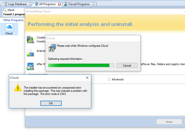

    Didn't work.  Have Win10 x64, iCloud 4.1.  Uninstalled O365-2016 just in case there are conflicts.  Used Revo to Force Uninstall iCloud, no luck, still get Error 2343!!!!!
    Note: uninstalling Windows 10 altogether, to fix the iCloud uninstall problem, is NOT an option.
    What other options exist??
    UPDATE:
    Actually, tried again.  Had to use force uninstall and tell it NOT to use the built-in uninstall.  Seems to have worked.  Will update again if it didn't.
    2015-11-13T14:07:31+00:00
    Just used Revo uninstaller on mine. It killed it and removed all of the associated registry files. Its got a 30 day free trial too so you don't have to buy it.
