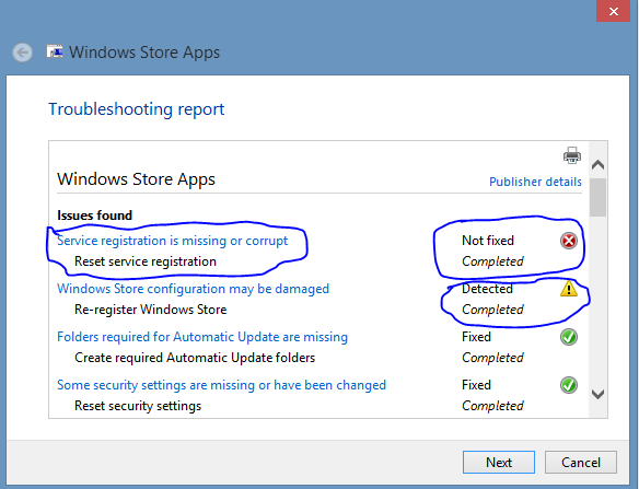

    Thanks Emkay 1001.  But the fixits did not help.  This is the message I received:
    Windows Update Publisher details
    Issues found
    Service registration is missing or corruptService registration is missing or corrupt Not fixed Not Fixed
    Reset service registration Completed
    Potential issues that were checked
    Some security settings are missing or have been changedSome security settings are missing or have been changed Issue not present
    Check for missing or corrupt filesCheck for missing or corrupt files Issue not present
    Issues found Detection details
    6 Service registration is missing or corrupt Not fixed Not Fixed
    Potential issues that were checked Detection details
    Detection details Expand
    InformationalService Status
    Problem with BITS service : The requested service has already been started. More help is available by typing NET HELPMSG 2182.
    Any further ideas?  I did look up HELPMSG 2182 but it just said to wait until processes are finished.  I've been waiting weeks now, so I don't think that is the problem.
