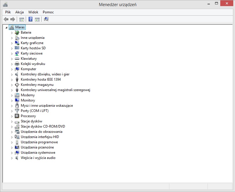

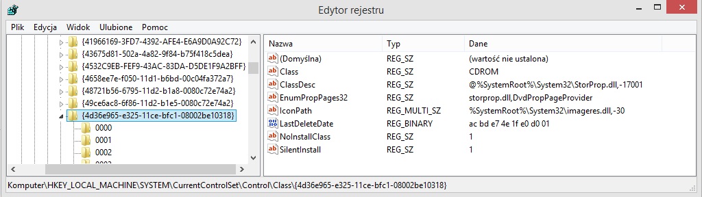

    I noticed a couple of things..
    What is the device "inne urzadzenia" with the question mark ?
    From your bottom picture it appears that at some time or another youe have had four or more CD\DVD drives... The folders 0000, 0001, 0002, 0003, all indicate a CD\DVD drive...

    Hey,
    I have a polish version of windows, nevertheless I don't see there anything that i could even relate to the "Initio". Print Screen of my Device Manager:
    And my registry key looks like that:
    So I don't see anything from the upper or lower filters you are writing about :(.
    I forget to mention, that week ago my system have seen the blu-ray. I wasn't using it for a week, the thing was disconnected, and now I connect it, I hear and see (led are flashing) it's working, but my system doesn't see it :(.
