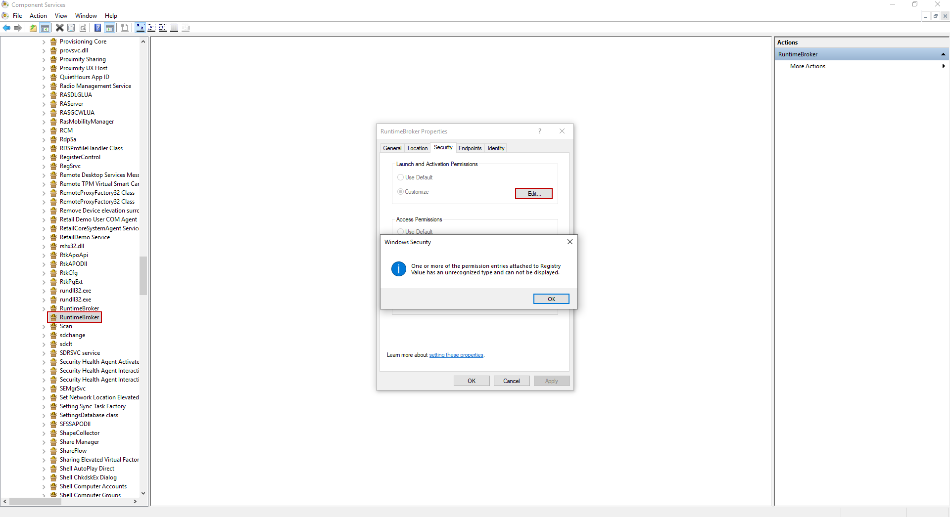

    hi all
    i already follow the instruction but in step 16 i have notification like this. So i cant add user or edit the permission
    i already change the owner for that application ID in registry editor to administrator(user). Please help
    Thanks before
