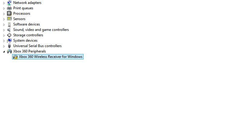

    Ok,
    So I know this is post is a little old but I was hoping it would help me regardless. I did everything, step by step just as you gave stated in the post. And I'm still not getting it to work.
    Previously it was "unknown Device" with that yellow triangle and exclamation sign on it. Now this is what I get.
    Please help me if you can.
