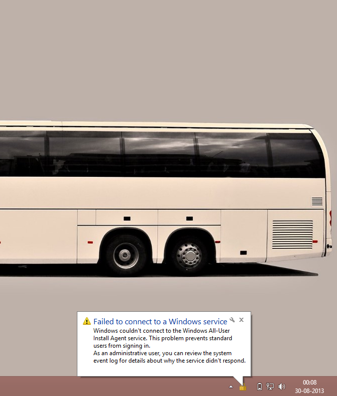

On day 2 after installing Windows 8 on my desktop PC, all user accounts with a standard profile are unable to log on. However, my admin account can log on and I get a message saying that the "Windows All-User Install Agent" is not running hence why non admin accounts cannot connect.
I have restarted the service but it runs for a few seconds and terminates with no message. Several attempts to restart it have failed.
Is this an issue with Windows 8?

The problem had been resolved by the time I got your response. I was at the verge of doing a system restore; but as I was trying to log back in to the PC, the log-on process seemed to be hanging as it went on forever, hence I did a forced shut down by pressing the computer on/off button and leaving it pressed down for several seconds. I then switched on the PC and alas! I logged on smoothly with all the issues gone! Some how the forced shut down as supposed to a normal shut down reset the system to my utmost surprise!!
