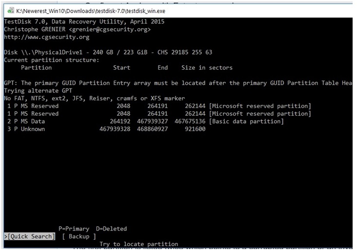

    Vinod N reply is good but it did not solve my problem.  Here is what did:
    There is a free piece of software you can use to quickly check to see if this is your problem -TestDisk.exe
    http://www.cgsecurity.org/wiki/TestDisk\_Download
    Be aure to read their instructions here
    http://www.cgsecurity.org/wiki/TestDisk\_Step\_By\_Step
    My problem looked like this
    NOTE: There are two (2) Partition #1's.  Both occupy the same sectors 2048 thru 264191.
    What I found was the first one listed was corrupt. (Do the QUICK SEARCH and then look at the files/folders in each)
    I used TestDisk to mark the corrupt one DELETED
    Then wrote the results
    I also had to use another piece of software called VisualBCD
    https://www.boyans.net/DownloadVisualBCD.html
    (also available via MajorGeeks, softpedia and cnet)
    But the basic problem was the weird added partition and TestDisk fixed that.

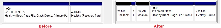

    I happen to have a Disk Management Screenshot before the problems.  Here is a before and after.  It look untidy but it works 100%
    NOTE - THIS IS A DUAL BOOT ARRANGEMENT. Normally you'd have an EFI Partition also. (In my case the EFI Partition is on the Windows 7 Disk)
