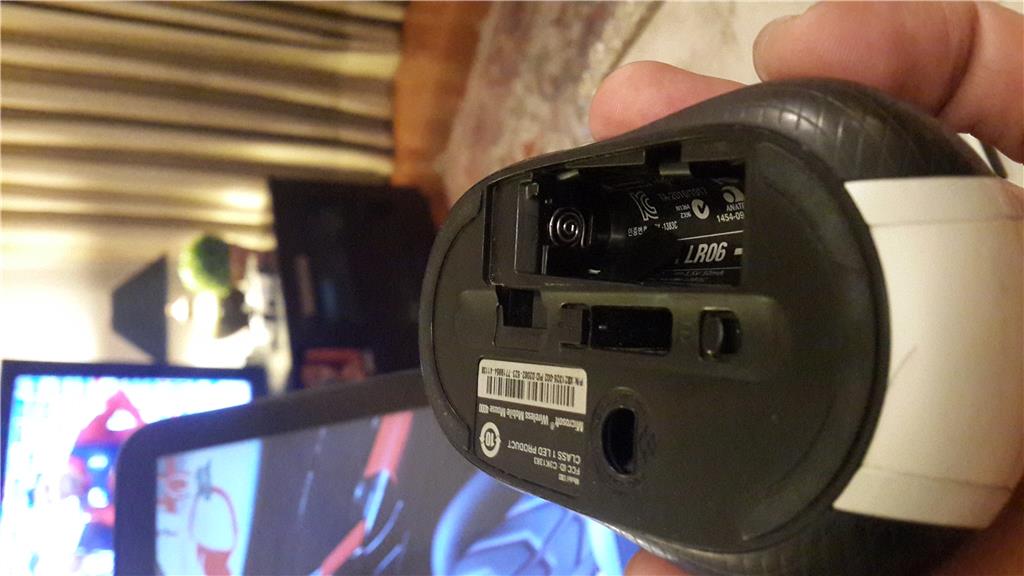

    2016-02-08T19:49:27+00:00
    I think I have discovered why this mouse is draining every one's battery including mine. lol
    Here's what I did which has worked for me. I'm not sure if every mouse has the same issue.
    See in the pic, the silver rounded wire or the batt linkage on this particular mouse is way inside due to which the battery's positive terminal does not come in full contact with it, causing the drain. Using a small screwdriver, I pulled it out slightly and reinstalled the battery. Now the battery sits better and the mouse has stopped draining the batt and is working even with batteries it had drained before. Cheers.
