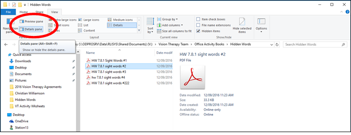

    2016-12-09T17:23:23+00:00
    I have experienced this issue continuously. I tried ending and restarting explorer only to find that the preview host was still supporting the document which was claimed to be 'open in windows explorer'. The WEIRD fix I found to this problem was to turn off the preview view in your explorer when you are looking through your documents. See the screen shot below for more details! Once I turned the preview off, I was able to delete anything I wanted.
