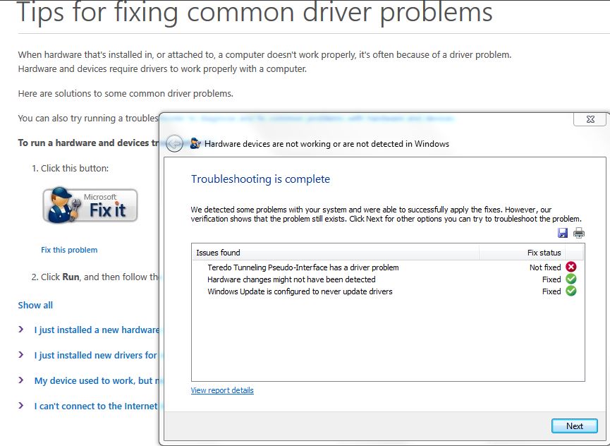

    ODDLY ENOUGH I don't have
    Peer Networking Grouping service,****
    all see in there is Peer Networking Grouping
    I tried to update it & nodda
    ALSO my sd card reader don't work any more
    it is b/4 not now how do I fix that too
    SO YEA I AM HAVING PROBLEMS AS WELL
    I did use the Microsoft wizard
    I just need some help plz
    with that & my sd driver
    how do I fix that
    that si why I di not disable stuff first want to make sure the stuff was there first.....plz get back w/ me soon ty
