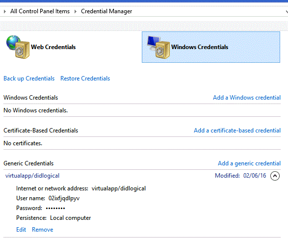

    Hi csiPost,
    Thanks for the info.  My Account is local also, BUT (old habits die hard) in Control Panel>Credential Manager>Windows Credentials and scroll way down, I still see an account under "virtualapp/didlogical" and have been told that is a link to a Hotmail account, so even if we think we are only local, M$ is still sneaking an account in on us.  I mentioned I disabled Credential Management, and deleted that "account" but if I log into Hotmail, it always comes back.
    Check yours and let me know if you see the same.  Just curious...  here's a pic of what I get, FYI:
    Don't know why or how, but it always comes back...  ??  BTW, I NEVER check things like 'keep me logged in' on sites, which I understand would also create an account here.
