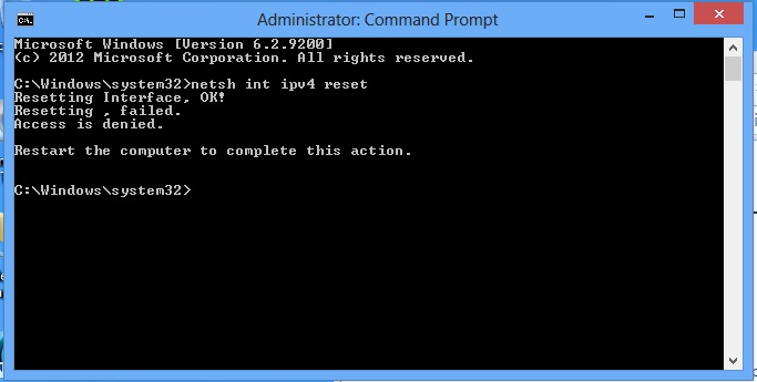

    Please help me, When i reset my ipv4, it does like this, it said "Access is denied"
    Please Help me Solving This Problem :D
