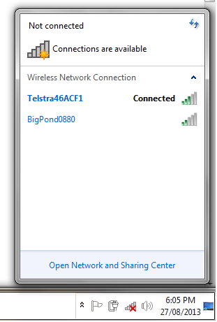

    2013-08-27T08:08:44+00:00
    This was useful to me for the most part.
    i was unable to set WWAN AutoConfig to automatic and start it as it said access was denied,
    i then uninstalled the network adapters and scaned hardware for changes, the updates were installed and it seemed to work for a moment!!
    but then it was trying to identify my network and the red cross appeared on my tray again and my network says it has no internet access when i am getting internet just fine!
