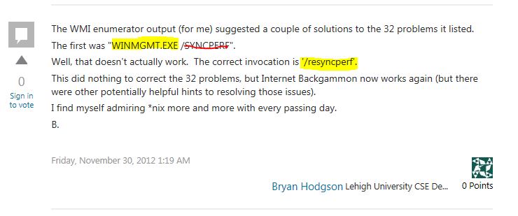

    Searching for a fix to this annoying problem is like searching for the proverbial needle in the haystack, but I did come across this thread last night..
    https://social.technet.microsoft.com/Forums/windows/en-US/4c131748-b9e7-4d48-90ef-6b4fe583bdfb/windows-7-internet-games-fail-with-error-code-0x8004100x?forum=w7itpronetworking
    Now its interesting that it mentions others have found that on Win XP continue to work as that falls in line with my thoughts and hence proposed solution, but its the post below that I found interesting and tried...
    (all credit to Bryan Hodgson)...
    I tried this and so far its seems to be working (but is early days)...
    If anyone else wants to try and confirm their findings, the more tests the better...

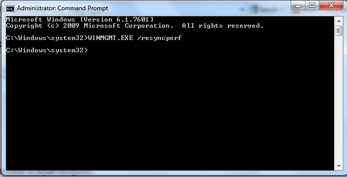

    To do this, start a COMMAND PROMPT (as Administrator) and type the command:-
    WINMGMT.EXE /resyncperf
    .. press return... It will run and not show any response as shown below..
    You can then close the window, and try running the games...
    Kevin
    Ok, guys, not sure this is a "silver bullet" fix, but I have found the game to be more "robust", if you run this command, but it seems to be needed every time you reboot.
    So I have put this command into a .BAT file and then put that .BAT file in to the STARTUP folder.
    Since I have done that Backgammon seems to be more robust. I sometimes get the message "Opponent has left the game and replaced by computer", which is really annoying as playing the computer is akin to playing my 4 year old nephew, but I guess that could be because the opponent connection has dropped out with the error, or sometimes I'm just playing a spoilt brat who doesn't like losing...
    Its worth a go..
    So to recap, create a .BAT file and in that file add the command WINMGMT.EXE /resyncperf
    Fingers crossed...
