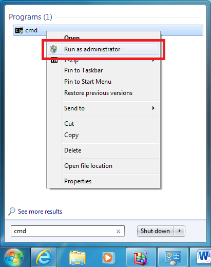

    1. Open an elevated command prompt (Click Start > Type cmd > Right-click and select Run as Administrator)

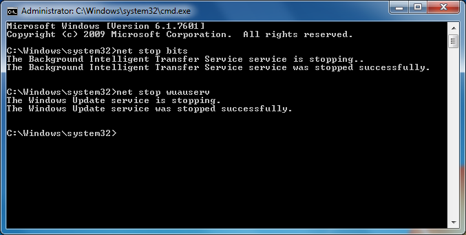

    1. In the command prompt window, type the following commands and hit Enter after each:
    net stop bits
    net stop wuauserv

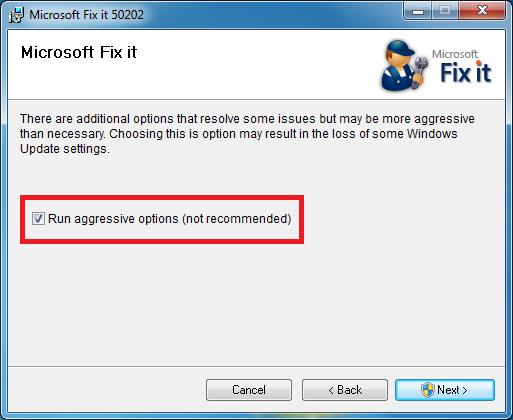

    3. Next, open the first downloaded file (MicrosoftFixit50202) and follow the instructions. Make sure to run Aggressive Options of the Fix it. When it processes, you will be asked to restart.

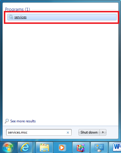

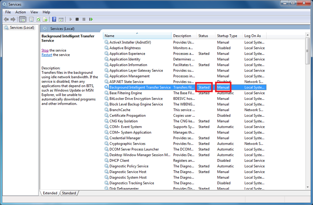

    9. Now we need to make sure the services used by Windows Update are started and are assigned the correct startup type. To do so, you need to open the Services console (Click Start > Type services.msc).
    1. Windows Update uses three services to function:
    a) Background Intelligent Transfer Service
    b) Cryptographic Service
    c) Windows Update Service

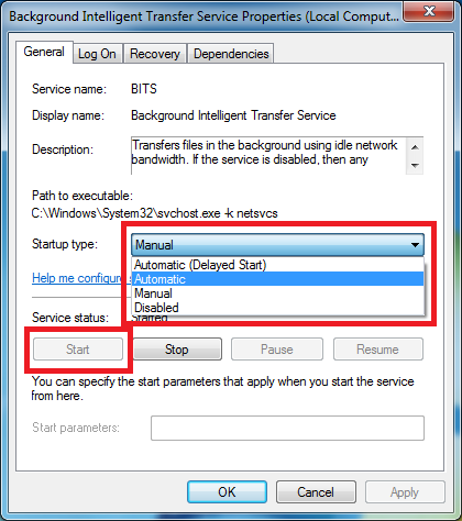

    Each of these services must be running and set to start Automatically. If not, double-click the service, and set the options manually. See the diagram below:
    In this example, the service selected is Started, and its Startup Type is Manual.
