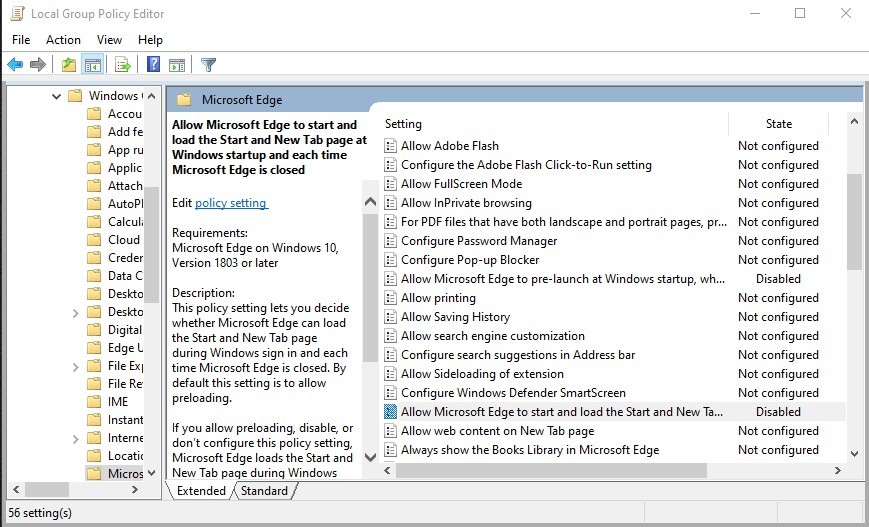

    2023-10-24T14:14:27+00:00
    Hi Pedro,
    I did the suggestions you made on the machine in question (gpedit, > etc., etc. ... no change.
    In Task manager the Edge process(s)(15 - 16) just keep moving into the background section,
    sometimes even stay up under the currently running processes ... even though I shut Edge down.
    Strangely, it worked a couple of times after I stopped the process (Edge) in Task Manager or
    force-shut down from Ccleaner. But it always came back to keep running in the background.
    Also:
    I noticed options in the group editor:
    • you can set to disabled Edge background under User Configuration but also under Computer Configuration. Computer Conf. also offers > App Privacy > Let Windows Apps run in the B.G. ... it is set to "Not Configured" However, when set to "Enabled" it gives you the option to "User is in Control" ...???
    Does it mean you have still control over individual apps or does it mean individual users??
    Anyway, I did not touch it - left to Not Configured since I don't want to jeopardize general Windows settings/apps.
    Also:
    There is another option, a few lines under "Allow Edge to to pre-launch ..." called "Allow Edge to start and load the start and new tab ..." ... it id set to Not Configured ... I set it to Disabled .. but I'm not sure if it makes a difference ...
    Edge process shut down a few times as it should in Task Manager.
    I hope it's getting not too confusing.
    Any further advise regarding the two options Allow Pre-launch... and Allow start and new tab... would be highly appreciated.
    Please advise: Not Configured ... does it leave any/all options open? ..set individually with each app? and where to set background
    behaviour for each app?
    What is tab preloading??? Is it even related to my problem?? Thanks
    Again - the other machine with Win10 always shuts down Edge at exit without any changes in gpedit. All on Not Configured.
    Thanks
    The second screenshot only shows the option ... I left it on Not Configured

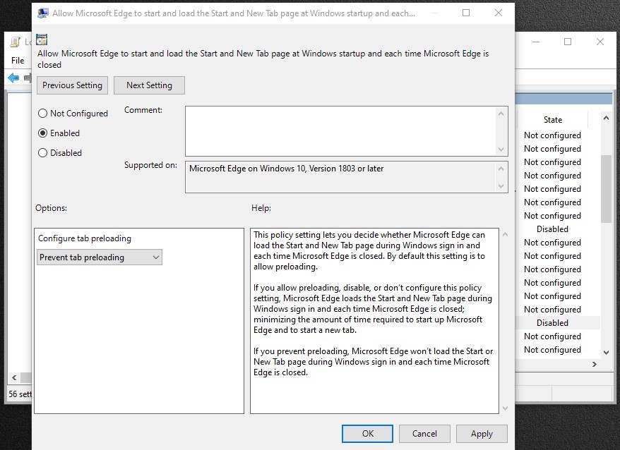

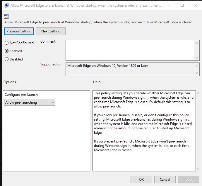

    2023-10-23T18:13:55+00:00
    Thanks for the reply.
    I’m not at the machine in question at the moment ... only at the other to compare / where there is NO problem.
    I followed your instructions to the end point where to disable.
    However, it is enabled for prelaunch, etc, even though this machine does not show the problem.
    So, I would think that this setting has nothing to do with the issue.
    Also: there are two options – first/top: "enable" or “disable”
                                            - Second/below:  two options: “allow prelaunch" or "prevent prelaunch”
    Which one to alter? both?
    Thanks
    I’ll be home later to look at the machine in question
