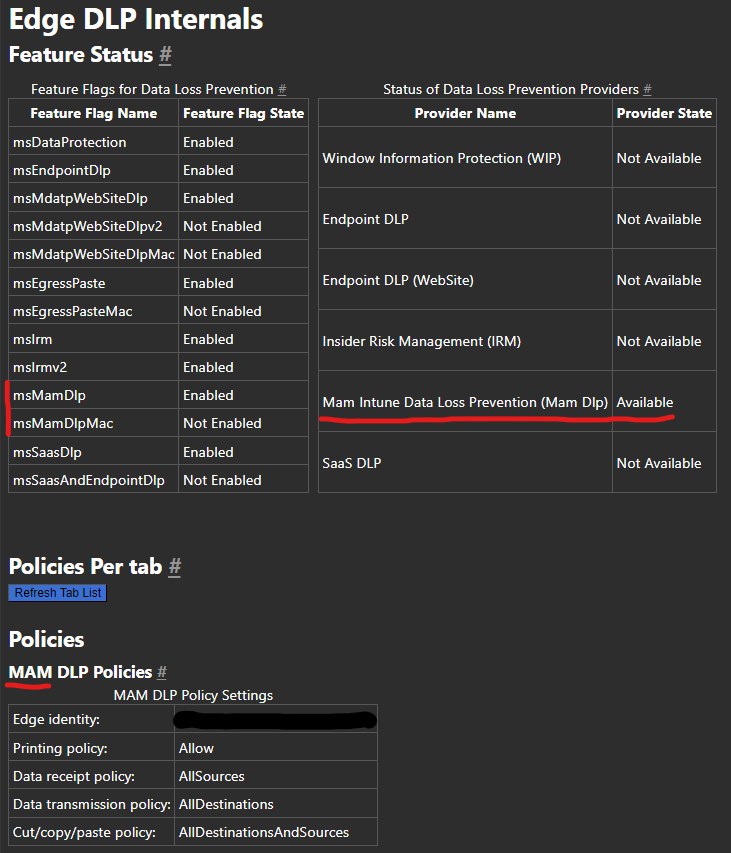

    2023-09-19T20:24:17+00:00
    I am not sure what MAM is - or whether I would be enrolled in it. Below is my screenshot of that page.
    If there is a way I can test un-enrolling from MAM (if I am enrolled), let me know.
    2023-09-19T18:05:27+00:00
    What does "Mam Intune Data Loss Prevention (Mam Dlp)" on the right-side table say? It needs to be "Available" for MAM to be a factor in this.
    "Mam Intune Data Loss Prevention (Mam Dlp)" is listed as "Available"
