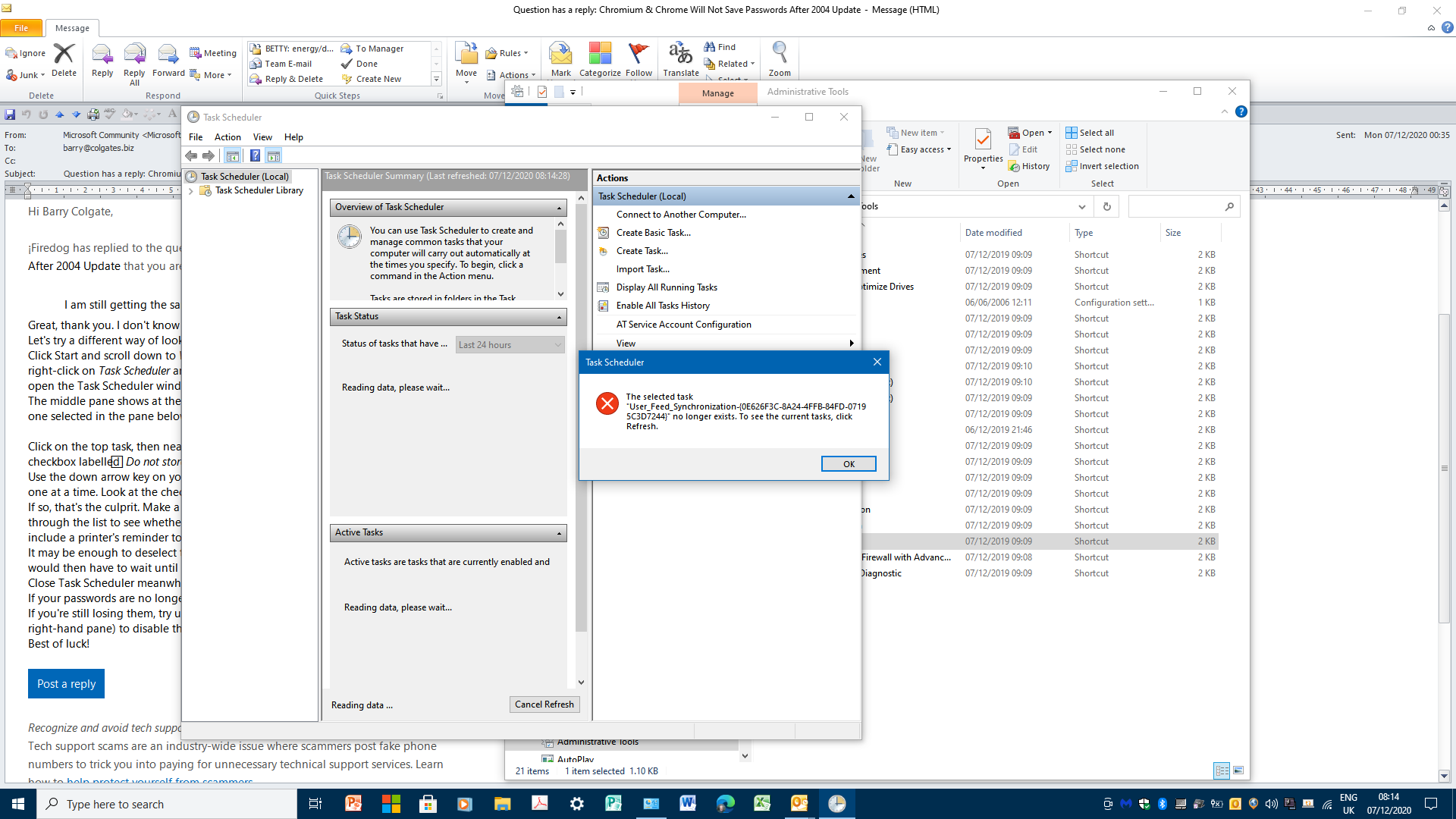

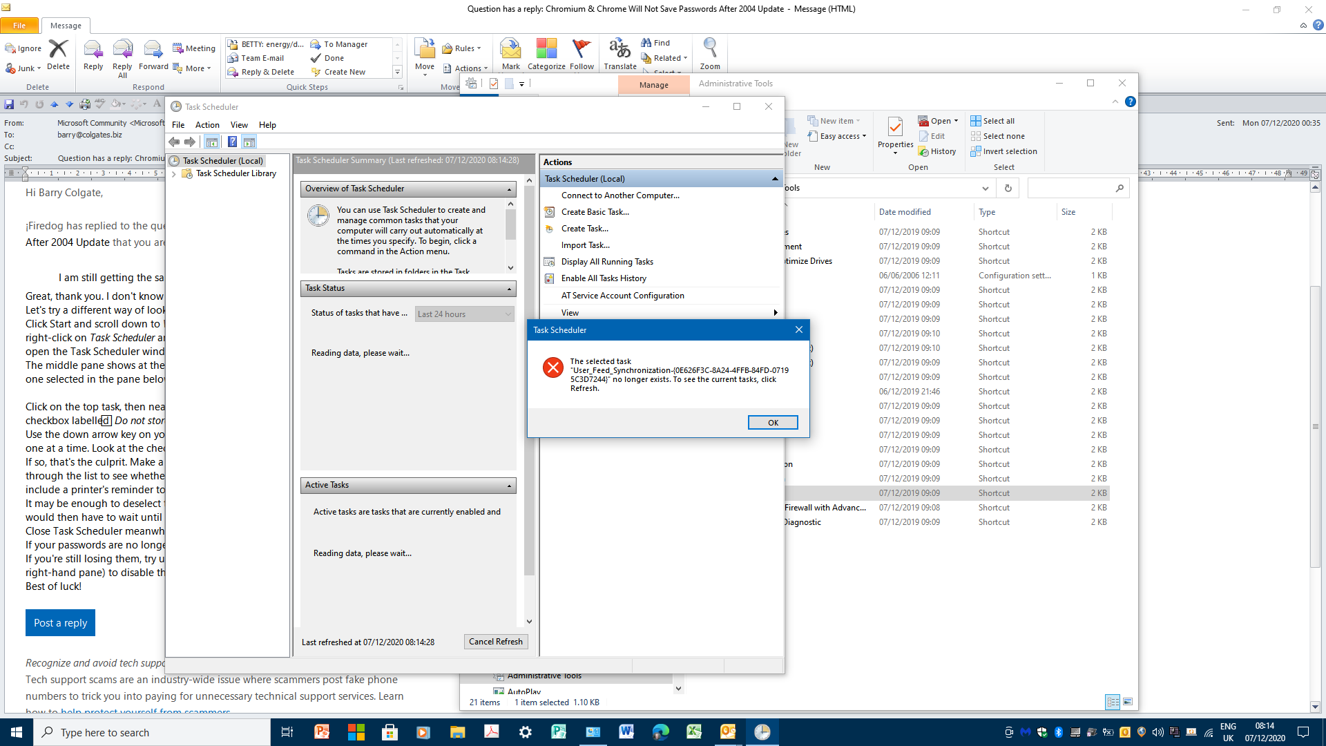

    There are two screenshots below.
    The first displays the error message when I open the TS window as Administrator
    The second displays the error message having pressed refresh.
    You will note there are no tasks scheduled.
    I am still getting the same error message. Here is the screenshot ...
    Great, thank you. I don't know why you're seeing that error; you ought not to ...
    I have tried to paste a screen shot but that doesn't seem to work here,

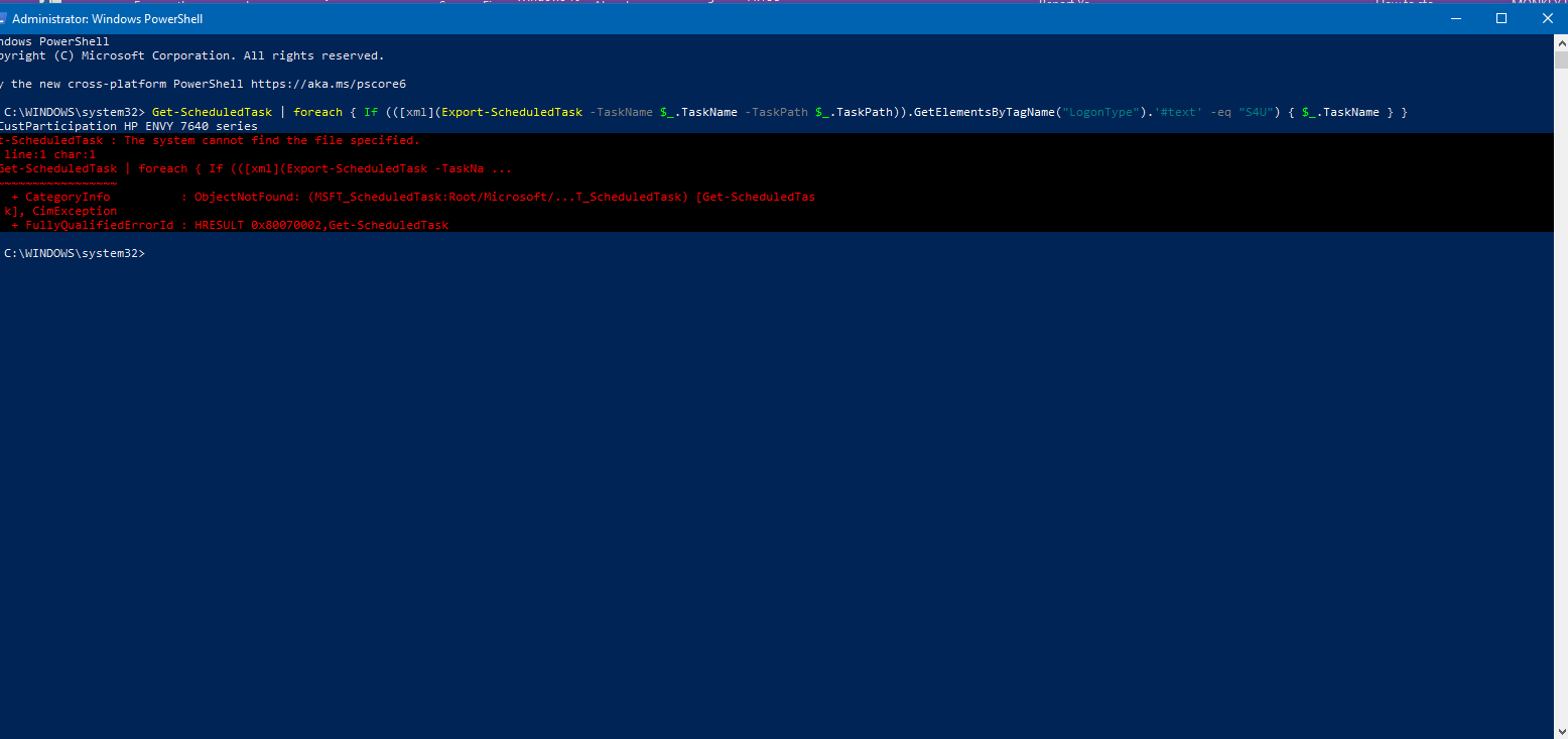

    I have tried the powershell suggestion several times - all I get is an error message 'system cannot find the file/folder'
