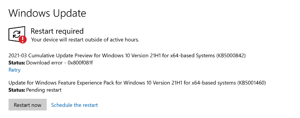

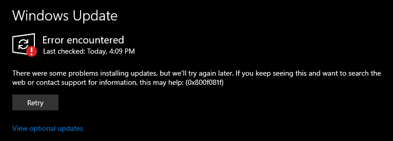

W.U. failed with error 0x800f081f W.U. on Beta from 19043.899 to 19043.906.
This was previously updated by W.U. from 19042.867 to 19042.870 and then to Beta 19043.899 without any problem.
Fails every time that I retry to install KB5000842.

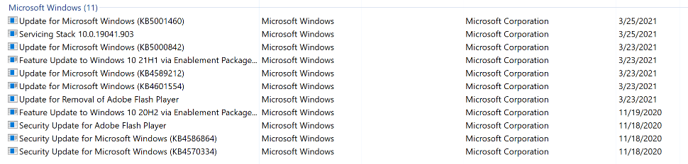

CP shows that there was already a KB5000842 installed on 3/23/2021 when it was updated to 19043.899 .
Something doesn't make sense, was it a different kb5000842 ?
Why is it trying to install the same KB5000842 ?
No option to uninstall it from the CP, so I will have to restore an older 19043 or 19042 to get this update to work.

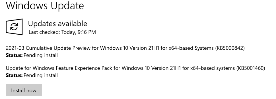

Hi Suat,
Does this look familiar:
Clean Installed 19043 in the RP vm. I removed the Enablement kb5000736 to use WU for RP. Not a chance. Putting this one back to snapshot of 19043.
