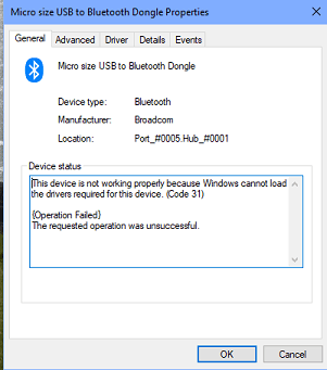

Please don't send me to the Community page. After uninstalling and reinstalling the radio, the computer now shows I have no Bluetooth at all. I already tried everything (Device Manager, etc.) I have Sony WF-1000XM3 earbuds. I'm running a 64-bit O/S. I'm running W10 version 21H1 (OS Build 19043.928)
I bought a dongle (USB 4.0). The file manager doesn't recognize the drive. It looks like my computer isn't granting permission to the flash drive, although the port works fine with everything else. When I view the properties on the Realtek Bluetooth 4.0 Adapter, the device status indicates it's working properly.
Should I start all the Bluetooth functions that are currently on manual and put them on automatic? I uploaded the Bluetooth Audio Receiver and cannot open a connection: those options are grayed out and it's on idle.  Are there other troubleshooting options I can do to fix the problem in case this doesn't work?

Can you remove the Broadcom device and make sure Bluetooth device that came with the motherboard is enabled in the bios, then make sure the drivers are installed ( get the drivers from the Asus's site), then check the device manager to see if it is working, if it is then try and connect your earplugs to it.
It hard to figure out if its a problem between the Bluetooth hardware and the operating system or is it a problem between the Bluetooth device and the device you are trying to connect which is the ear plugs

    The Bluetooth adapter that came with the motherboard does that not work at all or when it was going had errors. My network adapter the came with this motherboard has network adapter and Bluetooth so does both systems. Does your computer still have wireless connection? with your router but no Bluetooth.
    If you want the new dongle, I would disable the original adapter in the bios just for testing, the manual for your motherboard doesn't have a good bios section so I can't tell you how to do that.

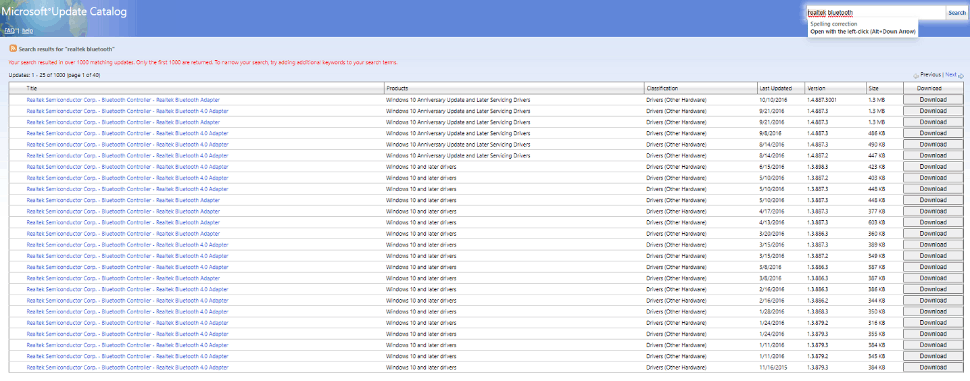

    Have you tried different USB's ports on your computer, check the device manager while plugging it in to see if it sees the device? Trying to find the drivers for that device might be hit and miss so I would just try different versions until one worked.
     I would also check to see if you have the latest bios installed and install all the drivers for your motherboard from Asus's site.
