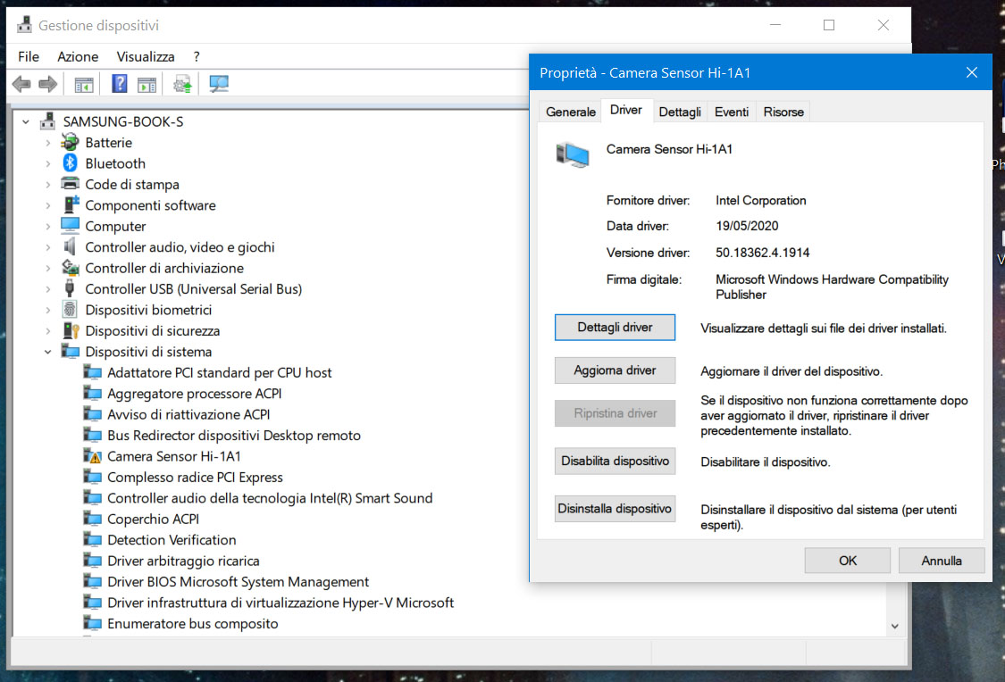

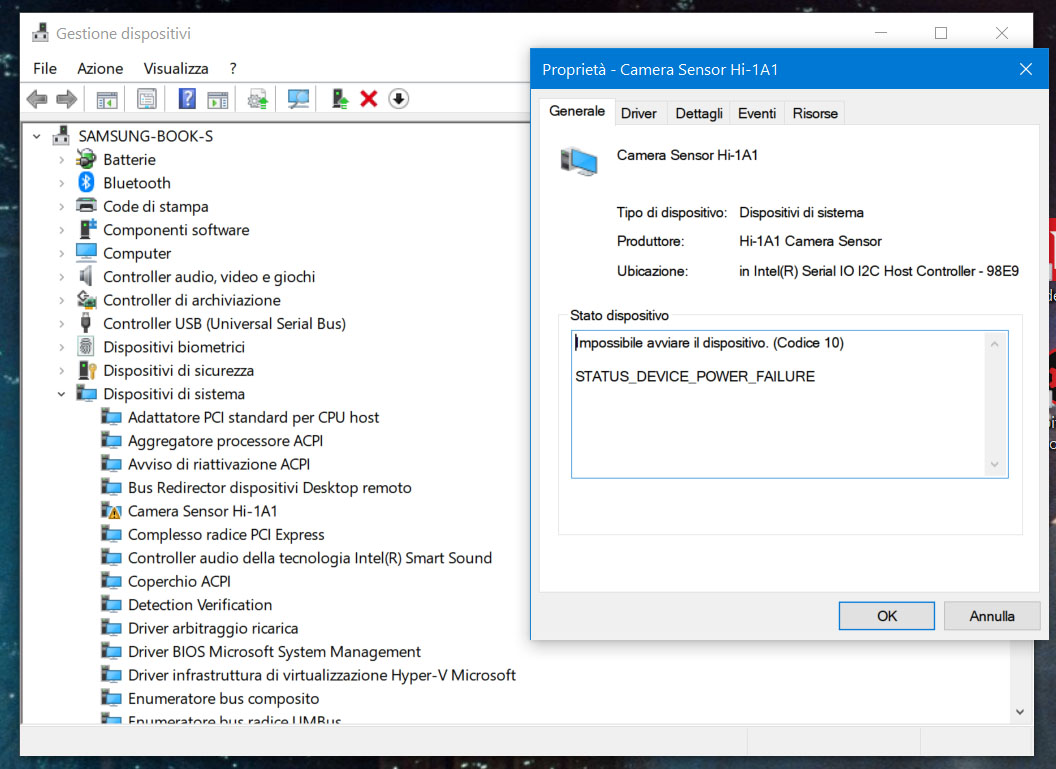

    2021-03-27T11:46:20+00:00
    I have a laptop PC Samsung Galaxy Book S - Prod. NP767XCM-K02IT
    with Windows 10 Pro 64 bit Insider Preview Build 21343.1000 and I have a problem with the  webcam drivers.
    As you can see in the screenshots below, the drivers of the Camera Sensor Hi-1A1 show an error:
    Code 10
    STATUS_DEVICE_POWER_FAILURE
    The drivers installed are from Windows 10, but the webcam does not functions.

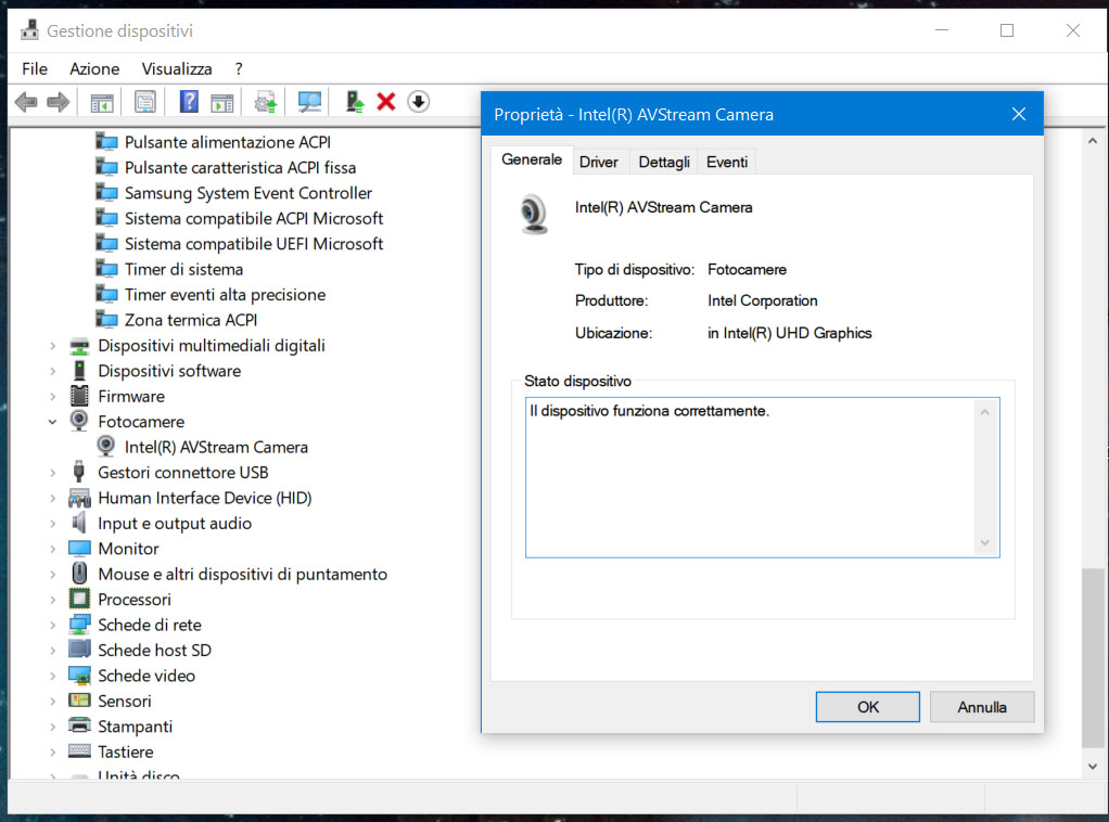

    As you can see from the other screenshot below, the other webcam drivers are ok:
    But the other drivers give me an error...
    Someone can help me to solve this issue ?
    Thanks in advance.
