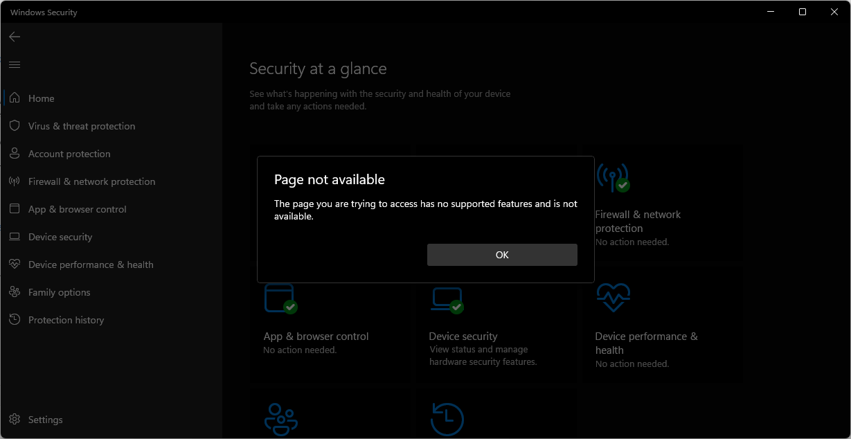

    I disabled Memory Integrity some months ago. But now, I tried to access to that page, I get this error.
    I don't know when, but Microsoft disabled support to Core Isolation for my device in some build.
