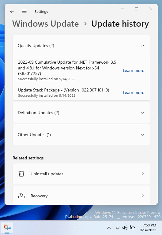

I had a problem for weeks. My device is in build 25174, and it's impossible for me to update Windows to later versions, like 25201 or 25197.
I have tried everything: clean flash, +100GB free space, DISM repairs, uninstall and update drivers, update from bootable USB... but impossible, always the same problem. It fails to turn on after the second reboot. (After reaching around 70% of the installation, it performs a reboot. Later it tries to start, but the Windows icon cannot be seen for more than a few moments and turns off as if the power was cut). Error code: 0xC1900101 - 0x40017

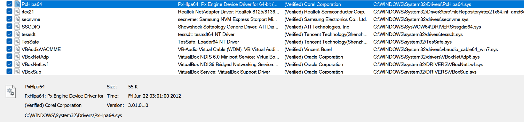

Final Edit: Finally, (in my case) it was a problem with the PxHlpa64 driver. I can see this is a known issue, there are reports from other users in this community that indicate it conflicts with Memory Integrity. At this moment, it's solved by removing it from the system.
Thanks to user iFish_木鱼 , since he found the solution having the same problem.

Hey guys, good news.
After ~4hours dig, I manage to fix this issue on both my pc&laptop finally.
Now I'm running on Windows 11 build 25262 with virtualization(SVM) enabled.
In my case, there is a system service named 'PxHlpa64', which comes from corel corporation, shutdown my windows 11 system on boot when SVM enabeld on 25188+.
Just disabled it via autoruns from sysinternals under drivers tab, problem resolved.
At the end I deleted everything about it found in registery.
Hope this information helps you.
Whole thing on my blog (https://blog.iccfish.com/?p=5241), refer to it if you need (in chinese).

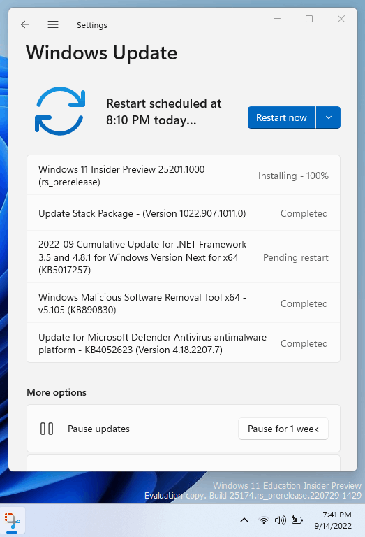

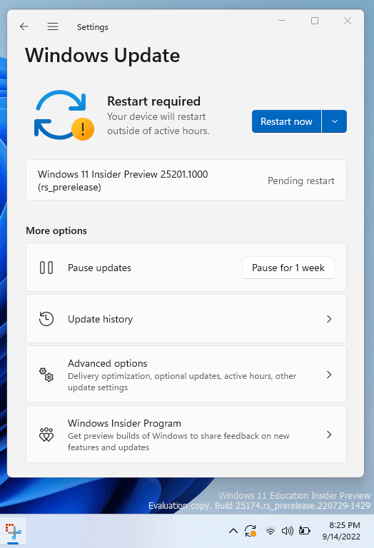

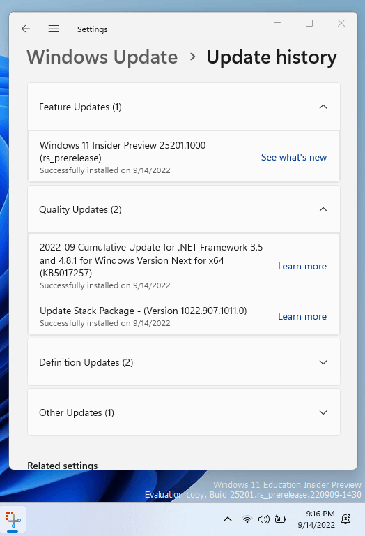

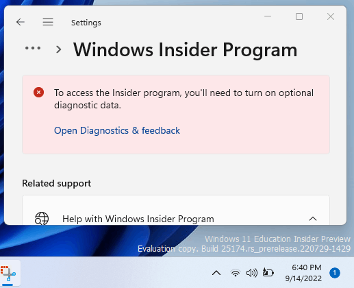

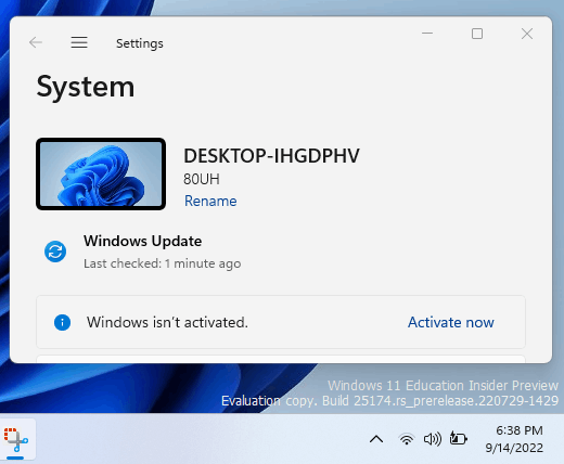

    This is a non-complaint laptop (yellow zone) with a 6th Gen CPU, similar to OP. I started with build 25174 Education, not activated, not linked to the WIP, didn't have to bypass login, used local account via "I don't have internet" but I had to adjust the date, otherwise WU wouldn't download nor install anything.
    I wasn't expecting to get Education Pro but I think the 2 users with the same issue may have had Education originally and later updated to Education Pro, that would explain the showing on the logs. If I look at my logs, I'd probably find something similar with respect to the base OS being Home SL but WU installing Pro.
    The first attempt failed, went thru the motions, restarted and ended up back on 25174 without any errors.
    2nd attempt, the update completed successfully without any errors.
