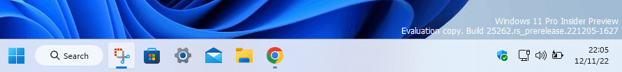

    LSAP was not turned of in my 25262.1000
    and Safe Mode shows my Task Bar normally.

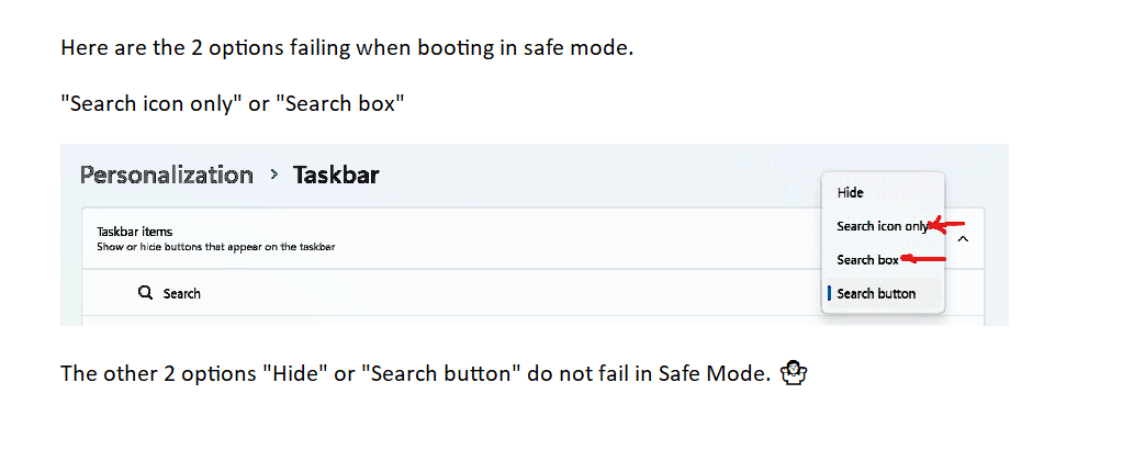

    If you don't hide it, what format do you show? Does it have the options in Personalization >Taskbar?
    oops! I'm sorry, I didn't realize that was a factor.
    No, I don't have the options, only ON/OFF. Remember that this is a clean install ok?
    That search button works fine, you don't have the SearchBoxOnTaskbar enabled, which also enables the Options in settings.
    That explains why you don't have the bug. If I disable that feature it work fine also in Safe Mode, tried in different systems, same results.
    I may try the Hide option to see if it still fails in Safe Mode with the feature enabled. 😎
    Edit:
    I just tried with the Hide option and that eliminates the bug in Safe Mode. 😉
    If I pick the "Search icon only" or the "Search box" it fails in safe mode, but if I pick the "Search button" it does not fail in Safe Mode. 🤣🤷‍♂️
    Verified the same behavior on 2 machines.
