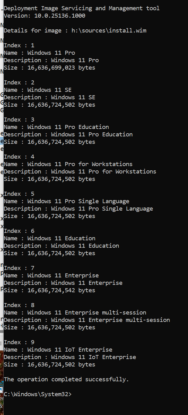

    Looks like that is intentional, the size of the appraiserres.dll is only 86 KB, compared to the normal one that is 165 KB. Sneaky! See the difference below.😉
    Modified file by AdGuard
    This is on 25136 from uup-dump same size as the official MS file.
    This is on 25120 MS Insider ISO, 165 KB.

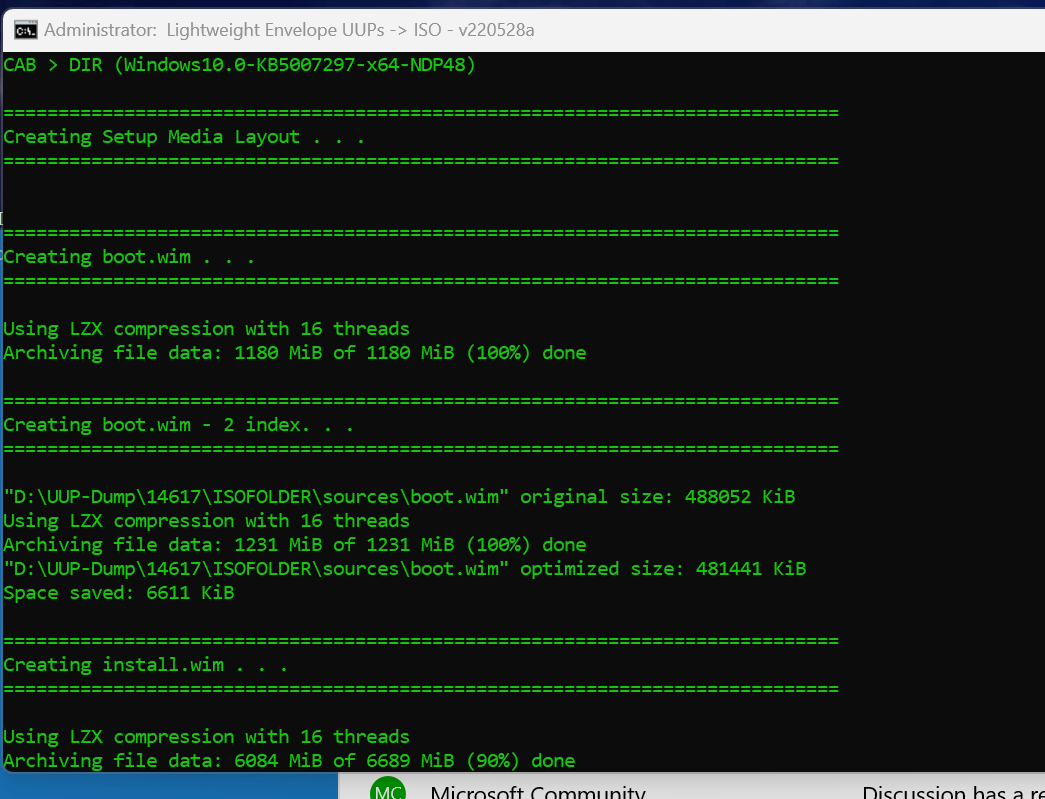

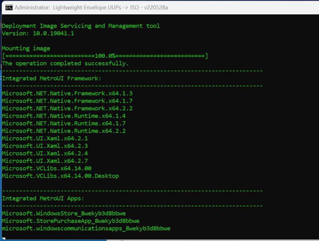

    All done.
    It took overall much longer than the script I used yesterday.
    The integration of the Apps is painful like the other one. 😵‍💫
    Looks about the same size as yours.
    install.wim still below 4GiB so it does not need any conversion or split.
