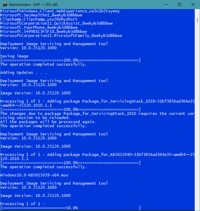

I created all 5 installation ISO files for all 5 Builds, but only 22557 contains all the system Apps required for a full clean install, the other 4 are missing all the basic Windows and System Apps needed for a functional system. Also, the App required for opening Windows Security (Microsoft.SecHeatlthUI) is missing, all this makes the resulting system unusable.
Last one on 22557.
Microsoft.SecHealthUI Microsoft.SecHealthUI_1000.22557.1.0_x64__8wekyb3d8bbwe

The official MS Insider ISO 22579 includes all the required Apps and the Microsoft.SecHealthUI which is needed for opening Security.

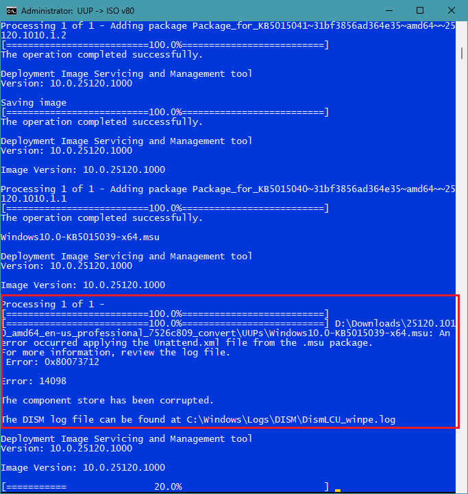

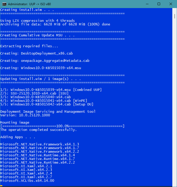

    Got one error at the end
    That looks like one of the errors I got, you can check the screen shots I posted earlier.
    Maybe depending on when you download the files, some may not be ready or being modified and then they cause the errors?
    Anyway, I have never got a clean run trying to build .1010 but I did with .1000.

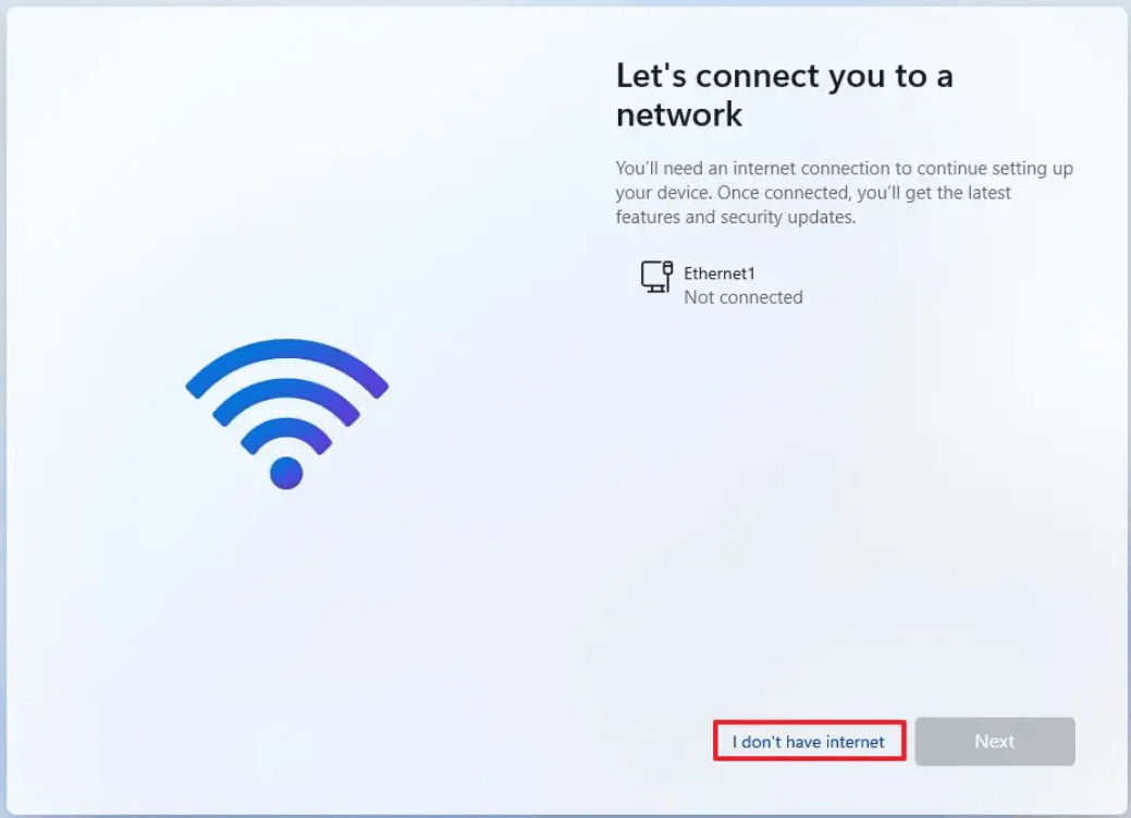

    As for the oobe\bypassnro, I press Shift + F10 when it gets to the network screen asking to connect then type the command. Then it restarts and when it gets to the network screen again, it has the option "I don't have internet" and when I click on that, it asks for the offline user ID.
    I don't know how you get to this screen with VM?
    How do you cut the network connection on VM ?
    Anyway, the second method suggested by Neowin while you are connected to the internet still works too.
    I just tried it and it avoided the MSA.
    Bypass Microsoft Account requirement when setting up Windows 11 with internet - Neowin

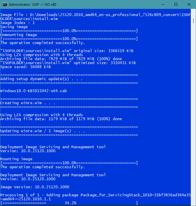

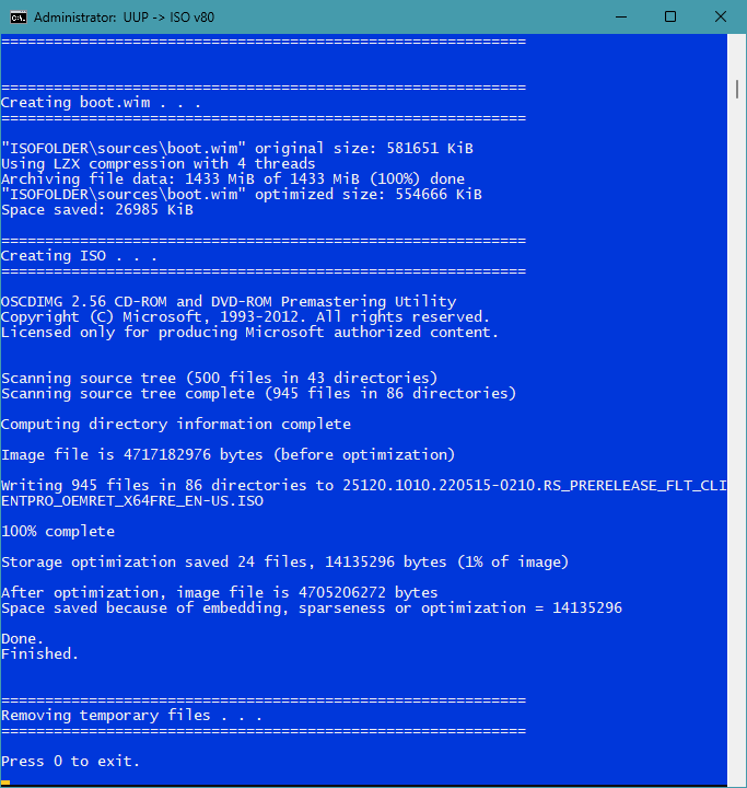

    The errors may go by, I got the errors and it still built 25120 .1010 this time, but never made it yesterday.
    You can see that mine is just a little bigger, but not by much.
    I tried a clean install with this 25120.1010 just built, without network connection, Shift + F10 and oobe\bypassnro still worked as it did with the MS official ISO.
    I'm sure they will eventually close this door too, but with this ISO it still worked. 😎

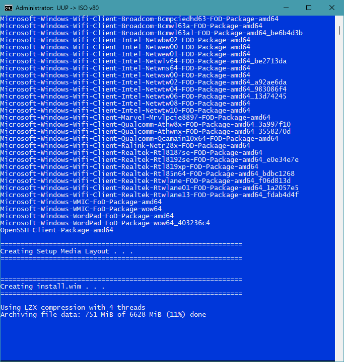

    The hack doesn't work for me on a VM 25120.1010 created with the ISO from dump
    I'm monitoring every step, no errors so far.

    Still, it reported several different errors during the process, see 2 of those below. πŸ˜’
    I still cannot understand how you get 25120.1010, it kept failing for me and for Johnny too.
    IDK, I didn't see any errors, I'll try again just to satisfy my curiosity.
    B.T.W.
    2022-05-25T03:01:32+00:00
