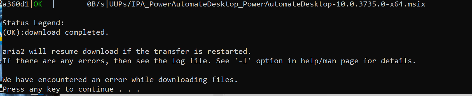

    Since I kept getting errors on uupdump download for 22616 x64 en-us Pro, I ended up trying the other method.
    I downloaded separately the "Any Laguage" Microsoft Store Inbox Apps to get the update version of the Apps and then merged the downloaded files with the SoftwareDistribution\Download uup files that came down with W.U.
    I then used the converter 79f to build the ISO with the Apps just downloaded and merged and made a new ISO.
    I will try another clean install and check if SecHealthUI is at the correct 22616 level.
    The 1st ISO I built was with the older apps folder from 22610 and SecHealthUI showed the old level accordingly as I expected.
    With last ISO I made as described above the level of the App is now matching the Build 22616.
    The regular download from uupdump kept failing all the way to 11:30PM Pacific time, maybe it will work tomorrow, but for now I got all I needed. 🙃
    Still, it is a pain in the neck to make it, but you can see that many Apps are at 22616 level with the ISO I built.

    Hi Johnny,
    Getting errors trying to download from uupdump 22616, I don't know where the log file or help/man is?
    Haven't seen that in some time. Just rerun the same script. It will grab whatever is missing on further runs. No need to clear anything. All files came in for me and I run that shortly after this build was released. Normally only see errors if run too soon, but its been awhile.

    Hi Johnny,
