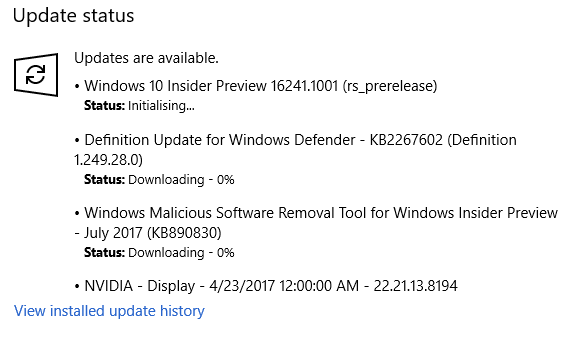

    update to 16421.1001.. for the 3rd time.
    Switching to Fast ring the update was downloaded and it appeared to work perfectly all the way through the preparation phase to the restart and install phase with interim restarts as around 30% and 70%.

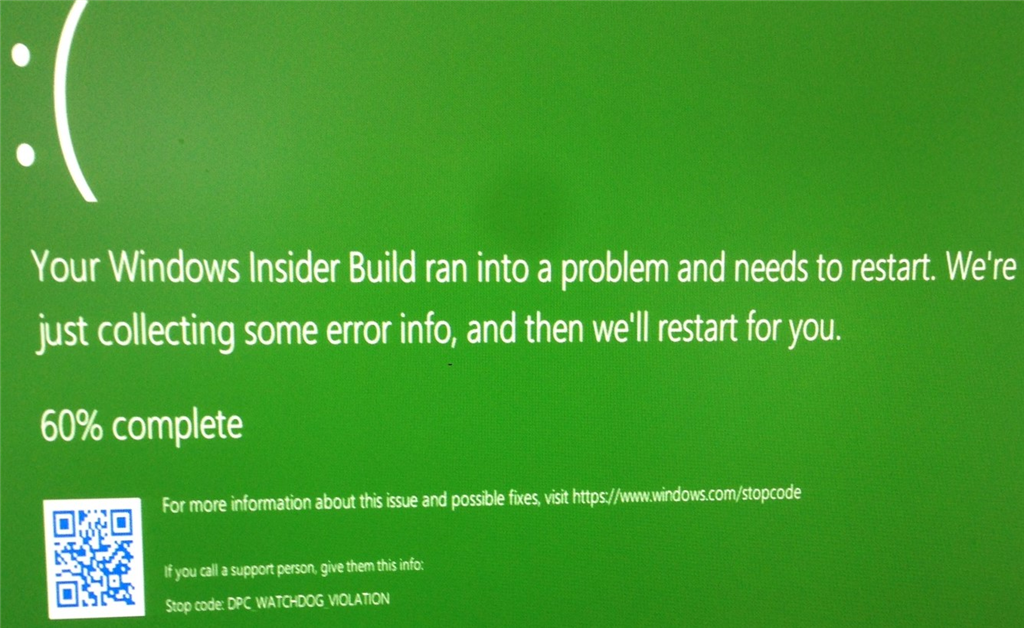

    Finally it has arrived.... great news.... well almost... .after the final restart a few minutes later my first ever GSOD!!
    It eventually restarted and, fingers crossed, no more issues will arise.  I've searched the error but nothing much I could find helps identify the precise cause.

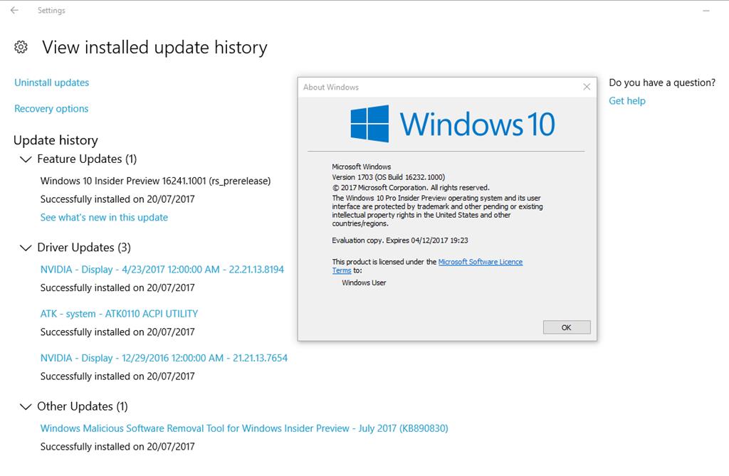

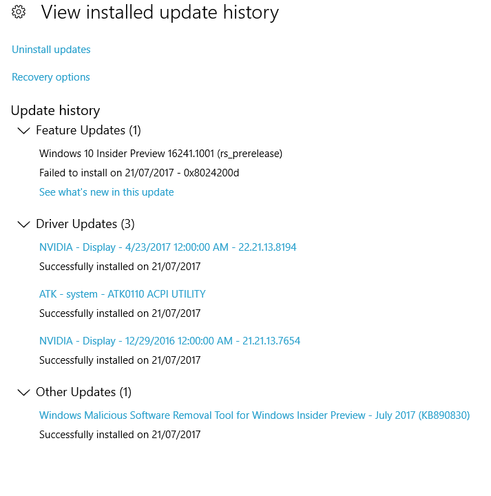

    32bit Install & Update
    16232.1000 booted and installed successfully, with Slow ring updates..
    On switching from the Slow to Fast ring and checking for updates saw 16241.1001 downloaded,
    carried on through the preparing to update phase
    but on “Restart” it did just that and only that. No installing updates on the restarting screen prior to shutting down and no sign of an update on the restart. The first update attempt shows the “Update History” telling me that it was “Successful” (?) while “winver” shows the installed build as 16232.1000.
    A second attempt, after another re-install failed.
    Why the inconsistency who knows but a third attempt is progressing as I write.... if I get a different result more later.
    Conclusion – It appears likely that the 32bit chipset drivers are included in the 16232.1000 build but were NOT migrated during the update process to 16241.1001 hence, on restarting, no update was performed and the reversion to build 16232.1000.

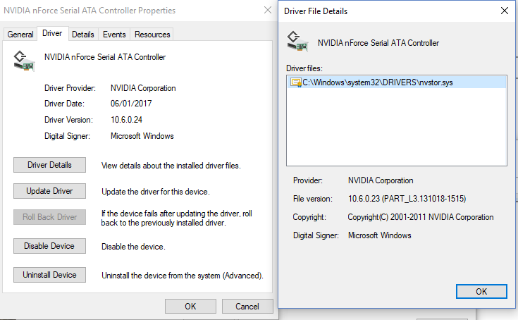

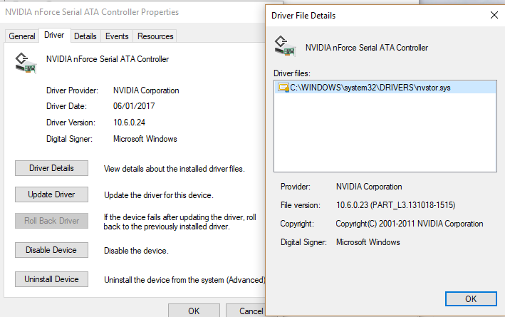

    So much so that I have adopted this as my primary working hypothesis. I will do some research on what's involved in (driver) signing in general and let you know if I find something interesting. But I have one question for you NForce750i owners which I can't look up. Could please look at your various installs and post the driver info? If you could post build, architecture, publisher, version , date that would be most helpful. Thanks already.
