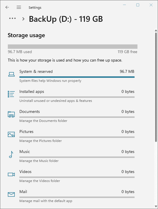

    2022-10-30T23:09:40+00:00
    227MB is nothing, it is probably needed for the file system, it shows some MBs on all drives.
    I'm sure you can delete your 14GB too.
    The ammount of data doesn't matter and I can't delete what I can't find.
    I appreciate your input but you're not getting my point.
    Never mind System Protection or Restore Points files, we are talking about System & reserved files that should not be on a secondary drive for many logical reasons.
    For example, what if the drive fails and needs replacement?
    What happens then if Windows needs that specific data for some type of recovery?
    I exchanged drive D: with a newly formatted one and Windows is still reporting a usage of 96.7MB of System & reserved files. Where are they? there are no hidden partitions nor hidden folders or files so what are these files and why are they there in the first place?

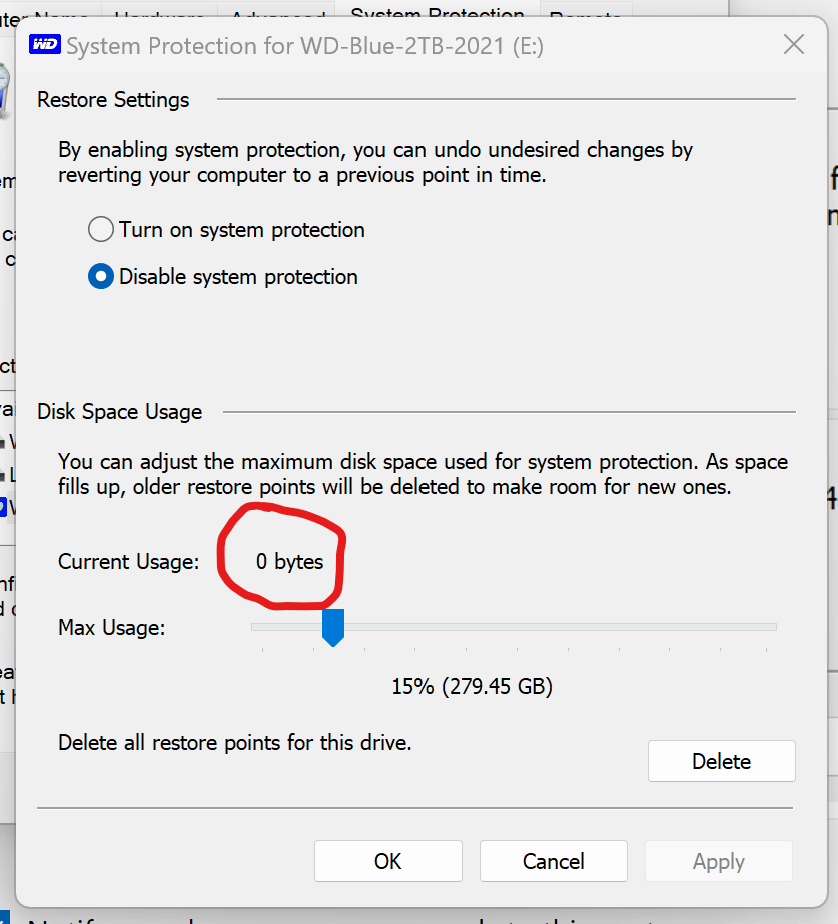

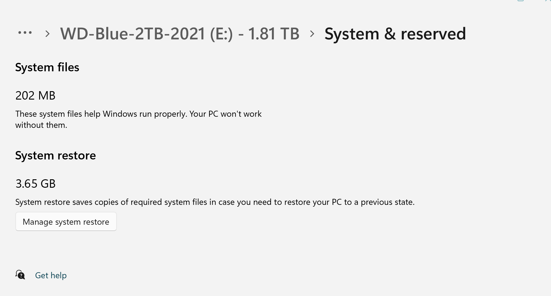

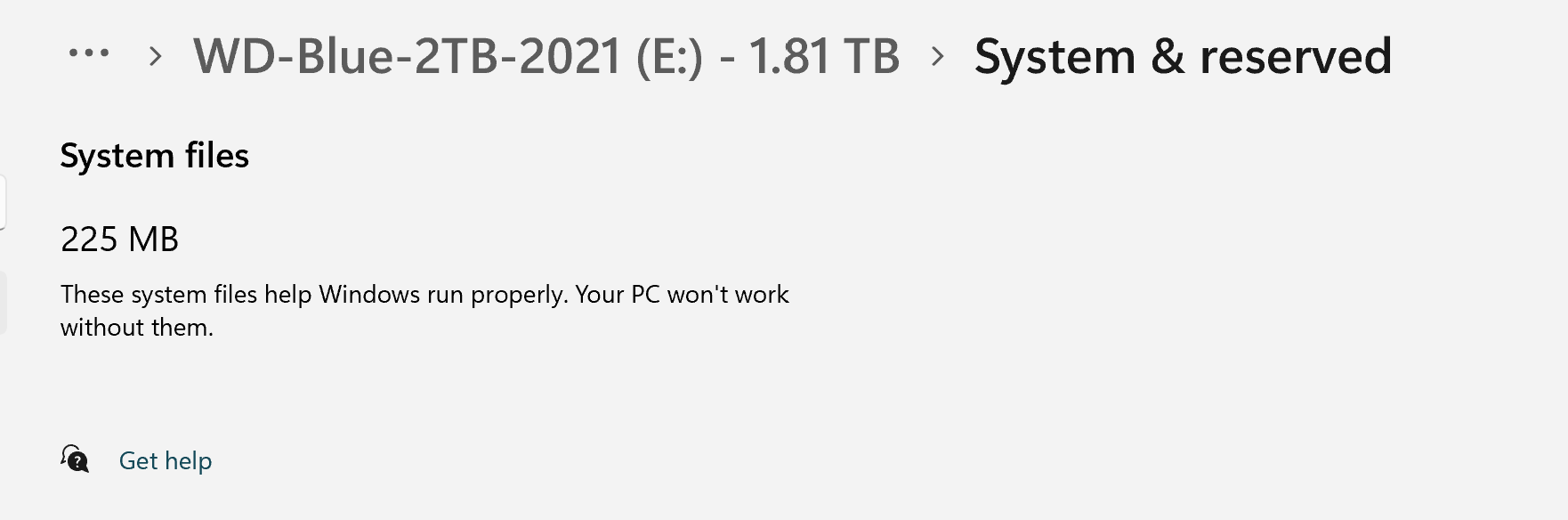

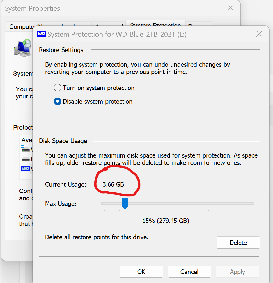

    2022-10-30T22:16:12+00:00
    Here is another normal case with Windows 11 22621.755.
    Before doing anything my E: drive showed this:
    After deleting restore points:
    Only System files left, this refreshed right away. πŸ˜‰
