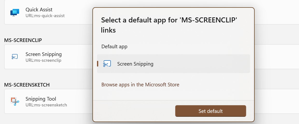

    The "+ New" button does not work at all when it fails. Setting MS-SCREENCLEEP as default as suggested in the blog, fixes the problem.
    Not easy to find where to set it, but it works. 😎🤣🤣

    If I reset all deafault apps, the snipping tool fails again.

    It worked here by setting this default, I had it fixed differently on previous build 25295.
