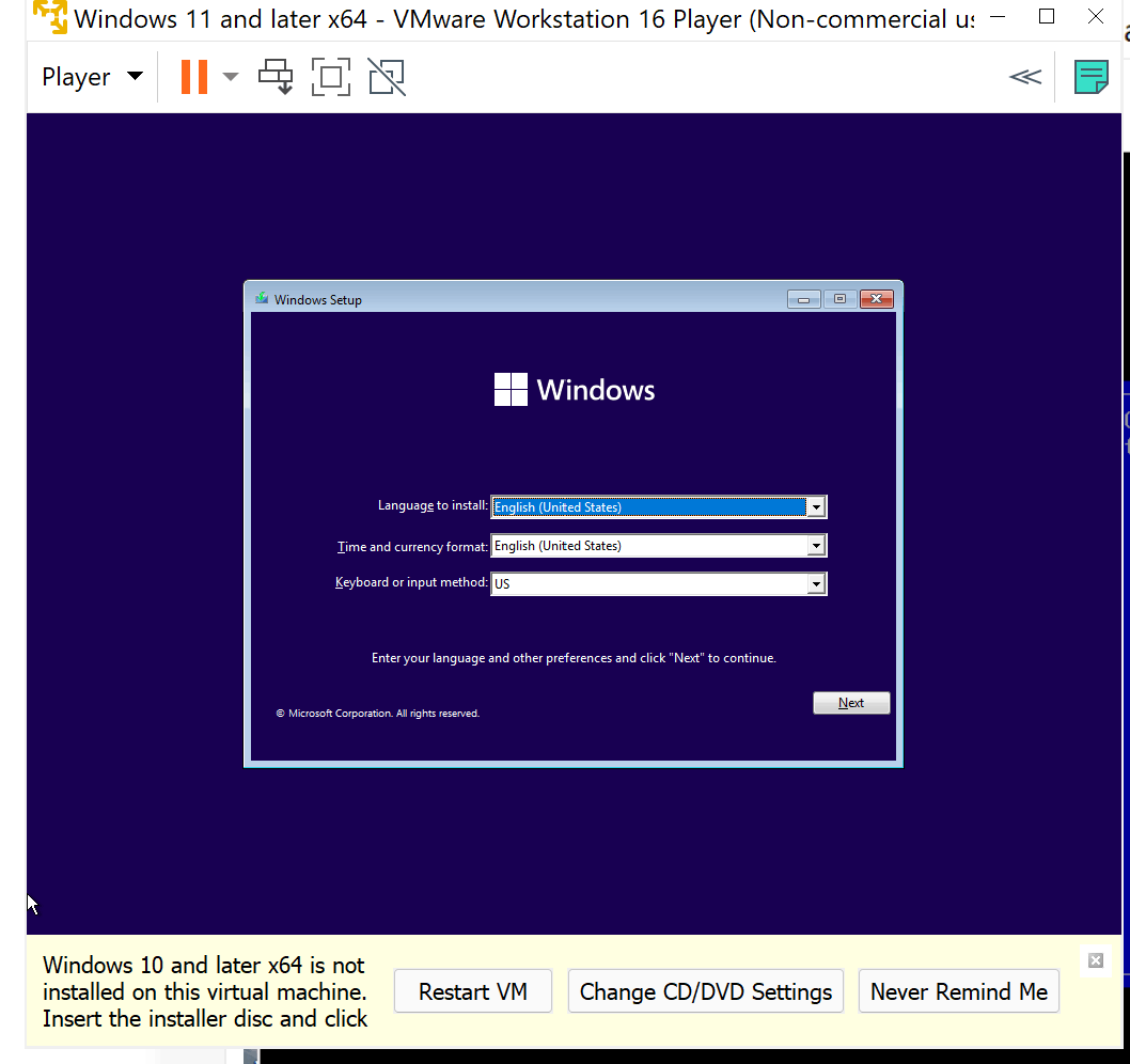

I downloaded and installed VMware Player 16.2.1 and Installed from the MS Insider ISO 22533.1001 on a Virtual machine.
I used the link below to add TPM, then the installation worked all the way through.
How to Enable TPM Support on VMWare Player - Website for Students
Added this line as suggested in the .vmx file:
managedvm.autoAddVTPM = "software"
Cannot go any further, I don't have a key to activate Windows 11 on VM.

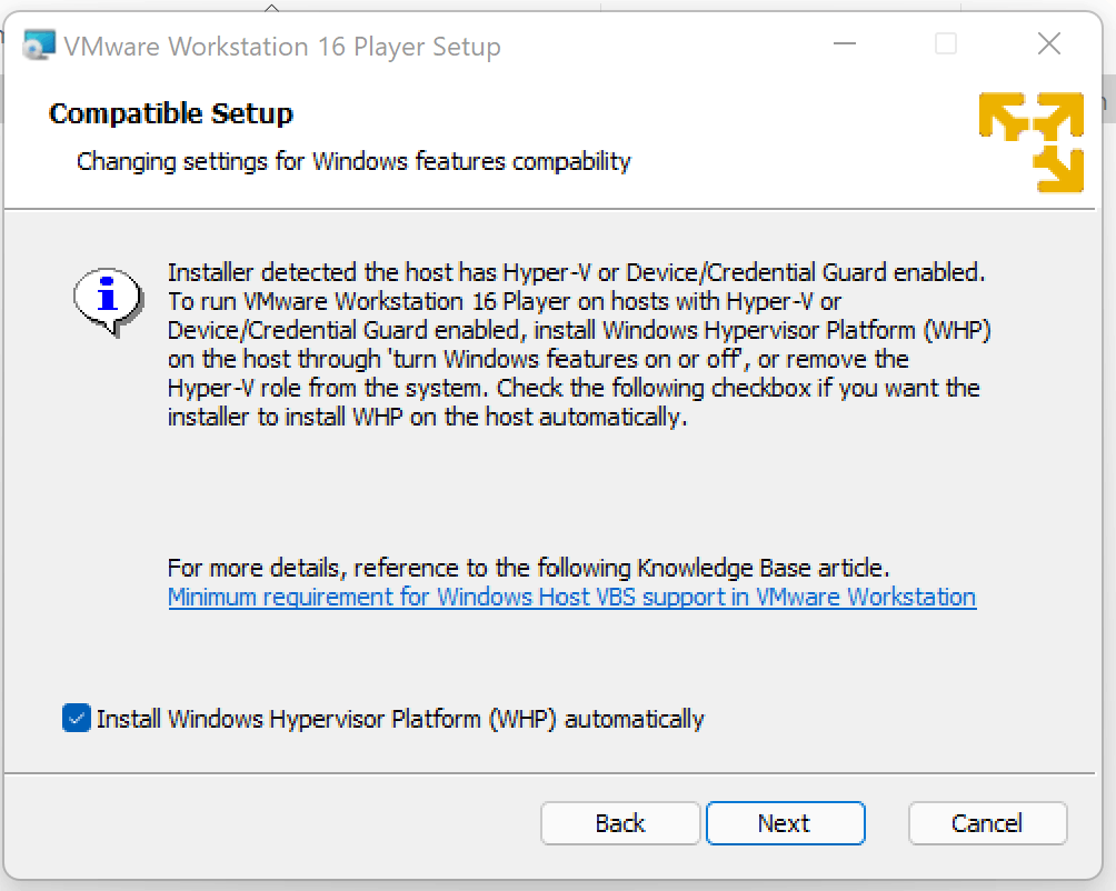

    If I remember correctly on with some older Windows and VMWare versions this line in BCD has prevent installing VMWare.
    I gave another try both with and without "Windows Hypervisor Platform" and seems to be working either way, not sure which one was faster anymore, a previous attempt without WHP seemed to get stuck, but when I tried again it worked fine.

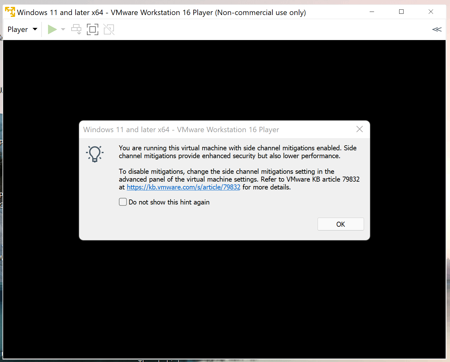

    This other warning, I don't think I can do anything with the free Player, the options are only on the Pro version.

    Do you have been Hyper-V installed in that device? Check this VMWare KB.
    Is there line hypervisorlaunchtype in in BCD? This interferer with VMWare player
    "VMware Workstation and Device/Credential Guard are not compatible" error in VMware Workstation on Windows 10 host (2146361)

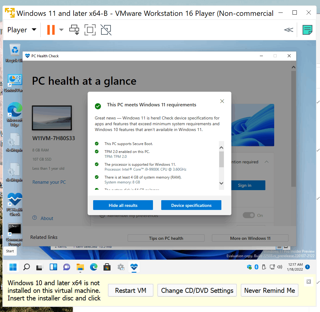

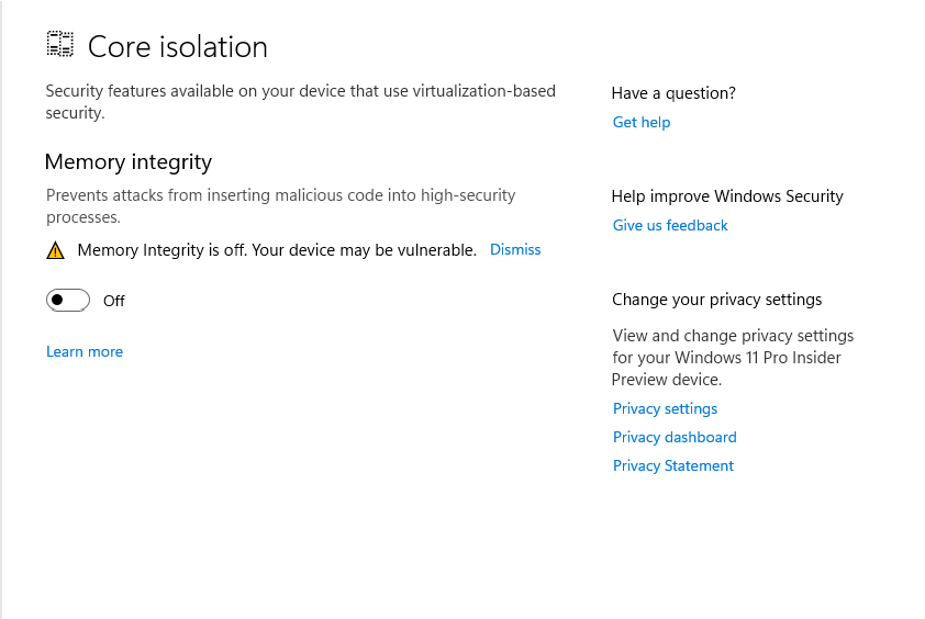

    I just cannot enable Core Isolation Memory integrity on the Virtual Machine.
    With this machine my Host system is Windows 11 22000.438
    Is there line hypervisorlaunchtype in in BCD? This interferer with VMWare player.

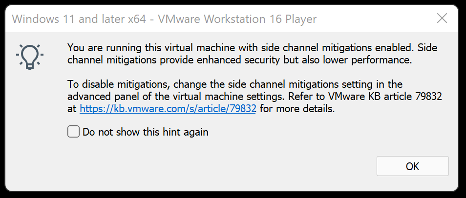

    Another new message:

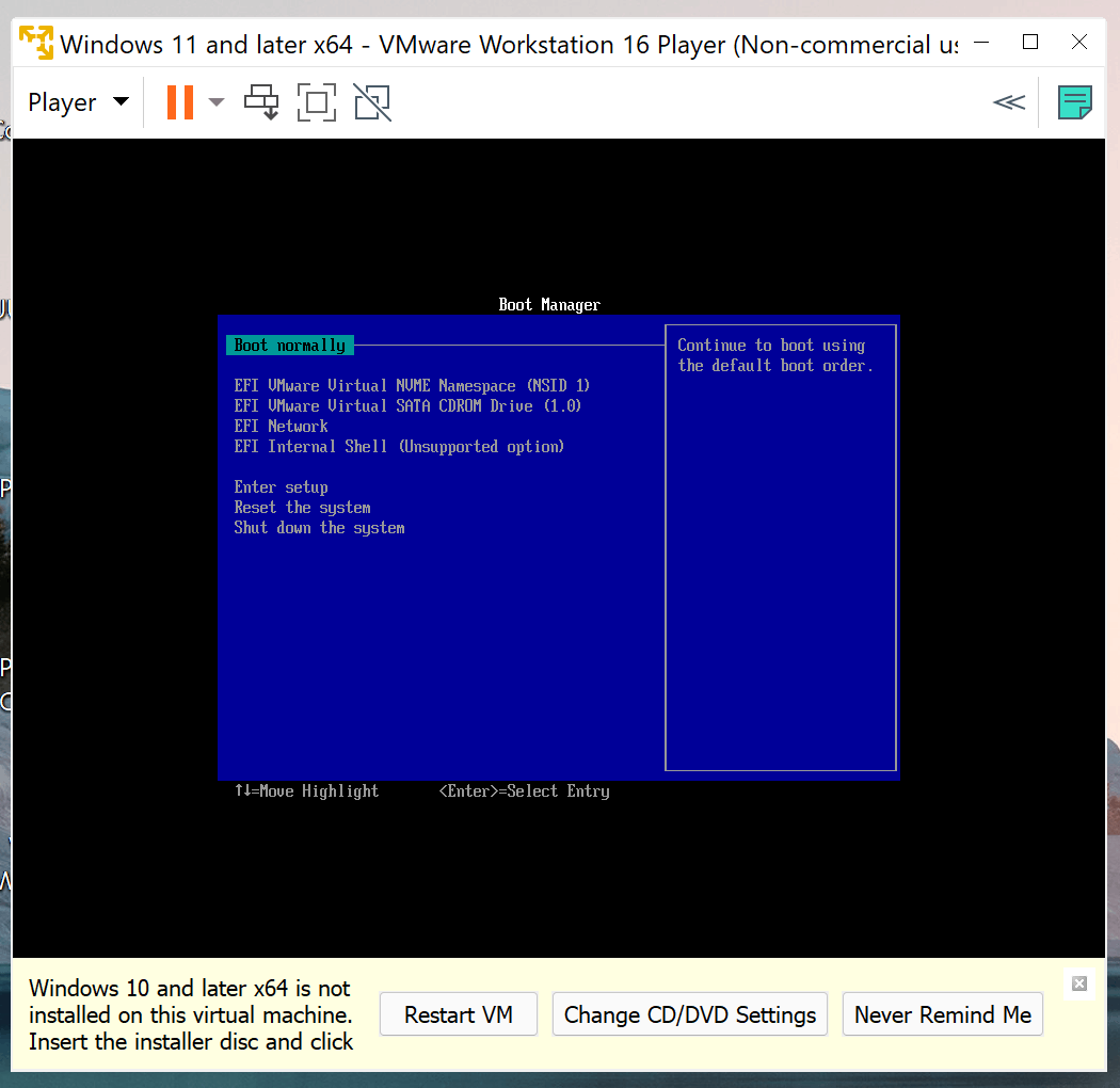

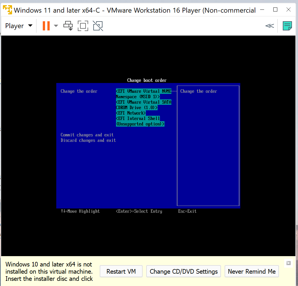

    Still got to wait about 60 secs for the timeout before it popped up the boot menu, then I selected the Virtual CDROM using the down arrow and pressed enter, then enter again on the next message for DVD loading....
    When on this menu I can also Enter Setup and change the boot order but did not find a way to get to the setup directly before getting to this point.
    And it booted from the Virtual SATA CDROM when I selected it on the menu.

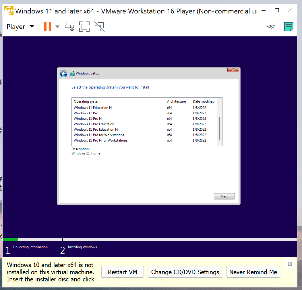

    I used the official 22533.1001 ISO.

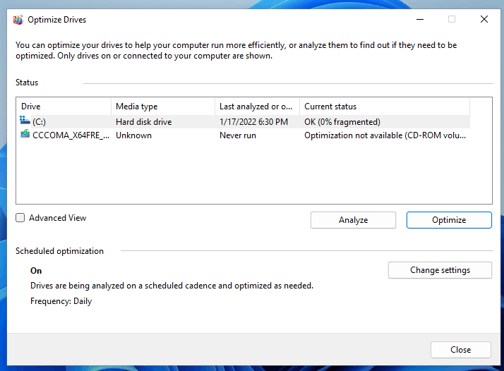

    Optimize works on the NVMe SSD, clearly not on the CD-ROM that should not even show on this screen:
    Memory Integrity cannot turn on for the Virtual Machine, even if it is on and fine on the Host.
