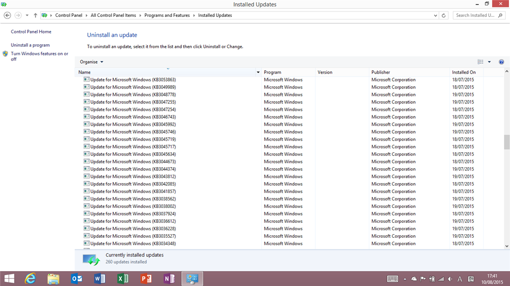

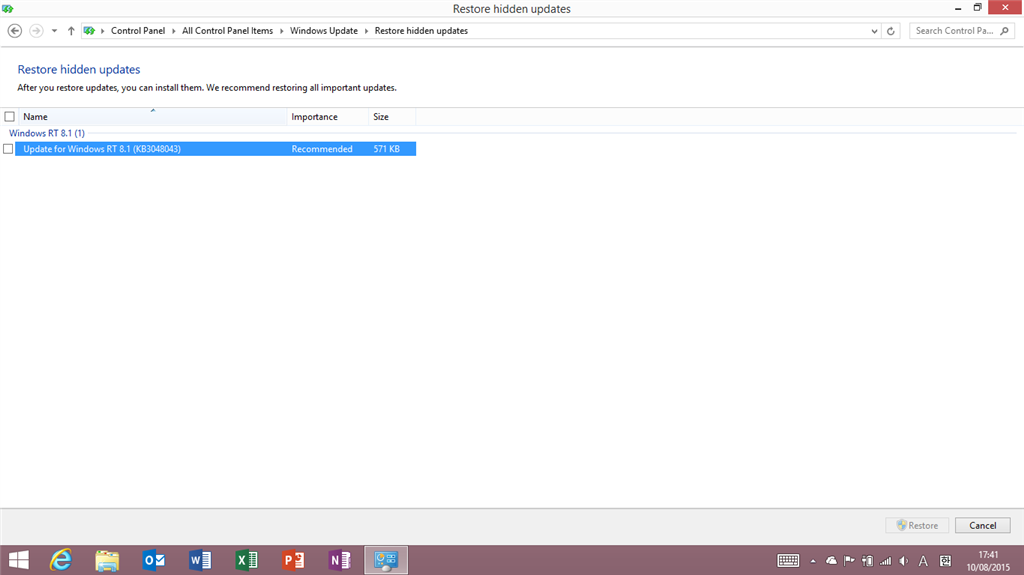

    2015-08-10T08:50:24+00:00
    that's strange. because this update even was installed on my desktop.
    check this pictures.
    these pics are on my surface RT
    If your Nokia have KB3048043, I think you have same problem with others.
    But I'm not sure because I don't have Nokia 2520.
