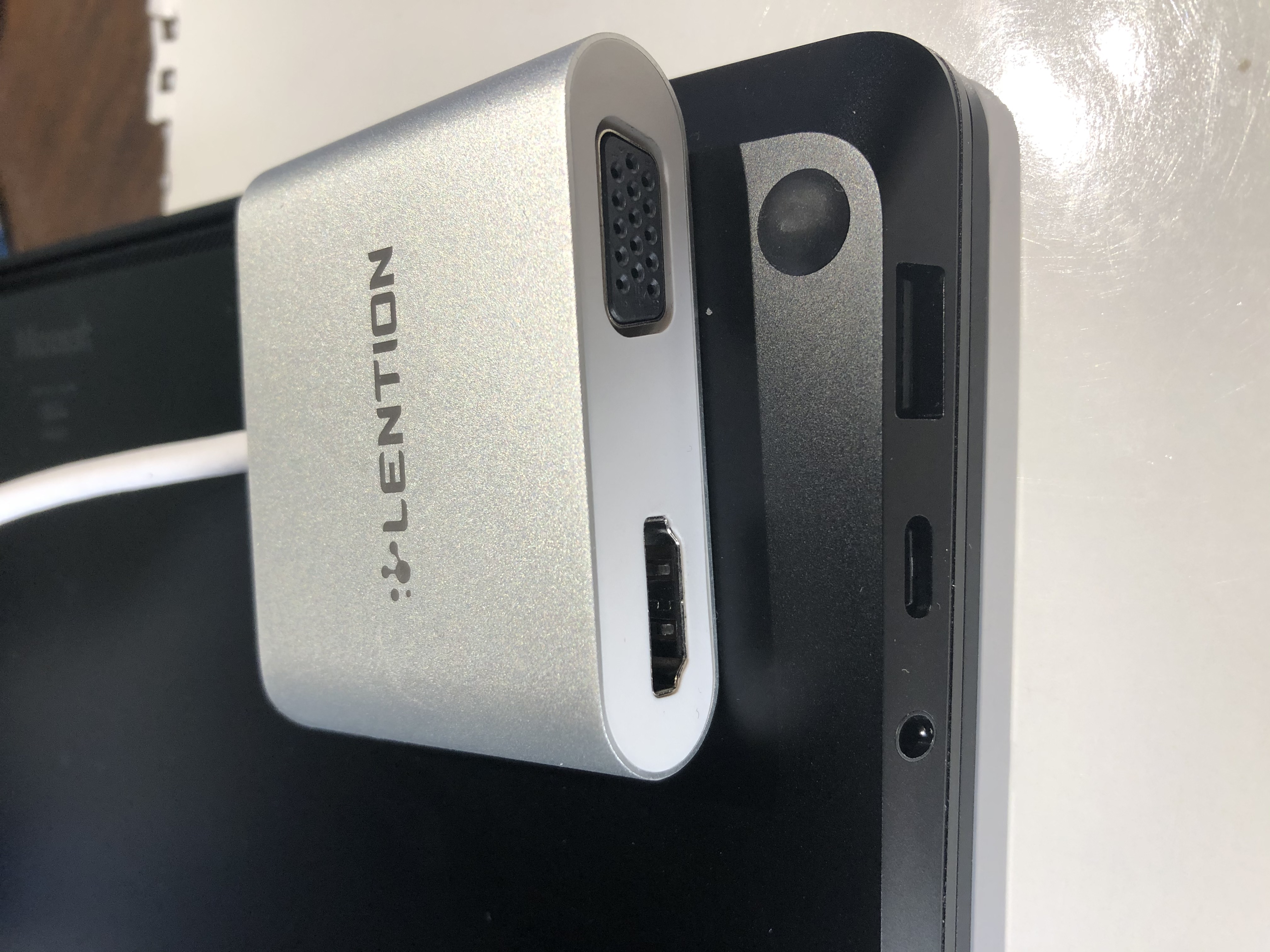

    2020-08-25T21:41:08+00:00
    Hi Bobby,
    That makes sense... I think we have the same ports on the Surface... one USB A and one USB C...    I bought a simple splitter to take the feed from the USB C and split it into an RGB and a HDMI feed, but its the same duplicated image.
    I can see what you have done. It seems I need the Surface Dock to get the extra two screens out. Can you tell me what Dock it is? is there a model number?
    Also, do you use the Surface screen at the same time as well? Or three completely separate external monitors? Which would make 4 screens if you counted the Surface as well?
    Thanks very much. You have been very helpful.
    Regards
    Willem
