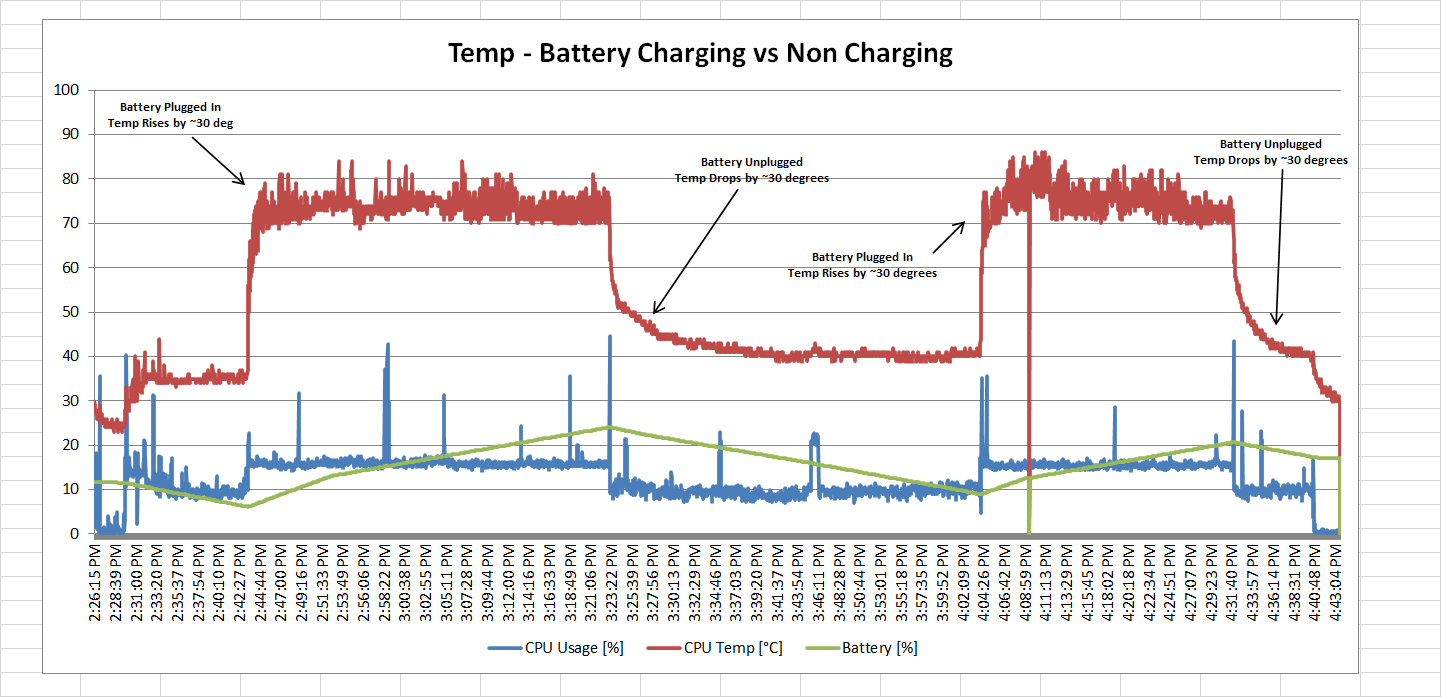

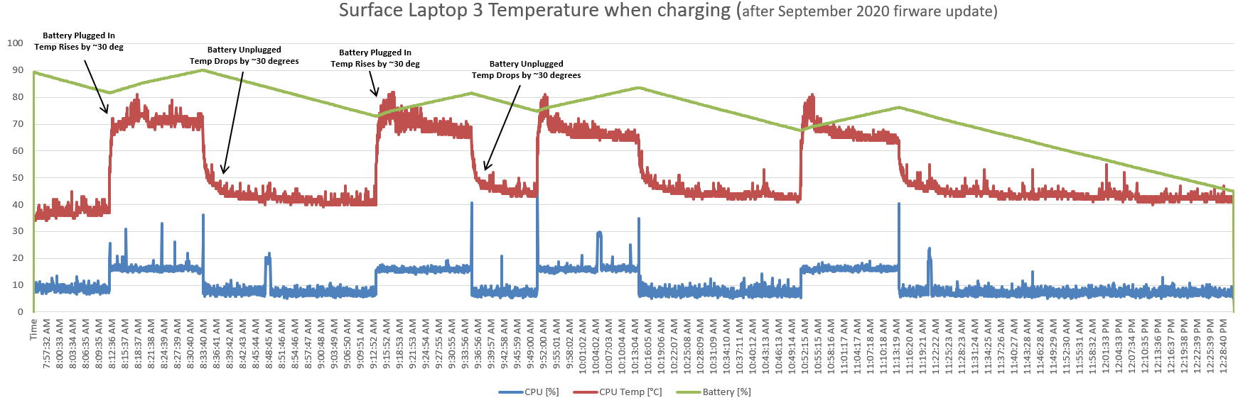

    My surface laptop 3 also overheats when charging (ever since I first purchased the device in February '20).  In particular, the device's temperature rises 30 to 40 degrees Celsius as soon as the charger is connected, and the temperature immediately drops when the charger is disconnected.  Given the heat, the laptop fan also runs very fast & becomes very loud.
    The graph below show how the CPU temperate increases by 30+ degrees as soon as I plug the charger in, and reduces by 30 degrees when the charger is unplugged.
    Unfortunately, the September 2020 firmware updates have not improved the situation (as shown in the graph below).
    Needless to say, I'm extremely disappointed that a premium device suffers this flaw, and that Microsoft seems to be ignoring the issue.
