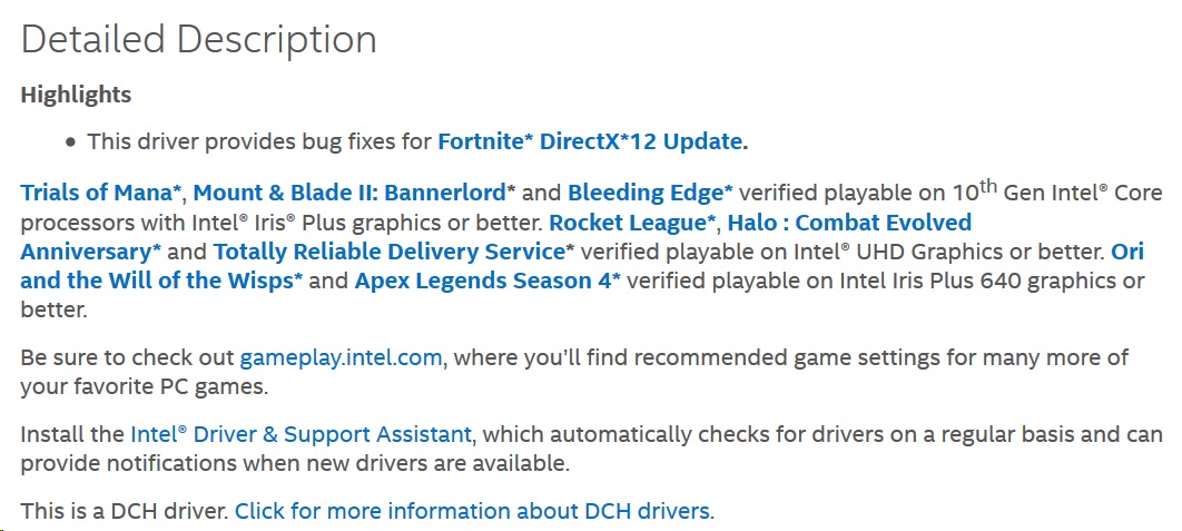

    If some of you are keen to do this, you can opt for this installer (Intel Driver & Support Assistant) provided by Intel (link). It will then help you to identify what are the latest drivers for your system

    Now, some people have suggested you install the very last Intel 10th-gen. generic driver from Intel's drivers website.
    Some manufacturers generally slightly tweak the display/graphics driver so as to prevent any unauthorised attempt from a third-party install package to update the driver - Microsoft did something similar with the SL3.
    Intel will tell you there is an update available for your display driver when you run their update tool on your machine.
    If you run the programme, you might end up seeing : "T**he driver being installed is not validated for this computer. Please obtain the appropriate driver from the computer manufacturer" and the setup process will stop.
    -- DO NOTfollow this procedure on a Surface Laptop 3 running on AMD architecture !
    Type "System Information" in the Windows 10 search box if you're unsure which processor architecture runs on your SL3
    Please follow the procedure described in this article to update your Intel display driver anyways :
    https://www.howtogeek.com/343287/how-to-fix-the-driver-being-installed-is-not-validated-for-this-computer-on-intel-computers/
    Make sure to select "*Graphics for 10th Generation Intel processors"*when you head over to the Intel Download Center.
    You only need to follow these steps once. Any further updates will install seamlessly.
    Following the update, some people have noticed a slightimprovement over the heating issue. It appears the computer manages heat dissipation a bit better and the fan will not kick in as much as it used to. Now, it's only a slight change meaning you may still experience your computer running hot on some occasion.
