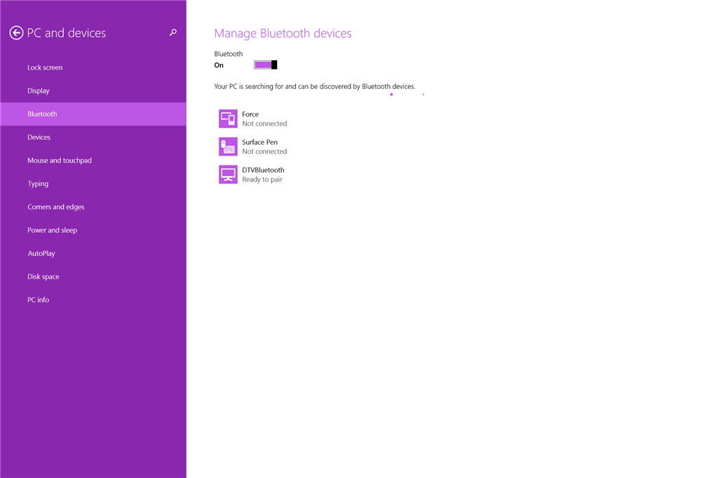

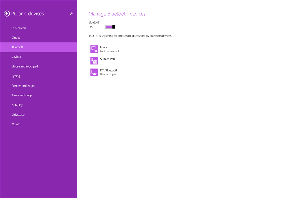

Furthermore, when I look at the Bluetooth settings screen it looks to me like everything is working fine.  Usually the Pen is "Not Connected" but it's showing up on the list since I paired it.  When I click the big purple OneNote button on the pen, the "Not Connected" message goes away.  It doesn't explicitly say it's connected, but the Surface Pro 3 is clearly recognizing the activity at least and it seems like it's connected (no error messages or indications of problems).  Sometimes when I press the button, instead of the "Not Connected" just changing to blank, it'll show a brief loading bar first and then look just the same (blank, without the "Not Connected" message).  Either way, the "Not Connected" message comes back after about 5 seconds, which seems reasonable if it's connecting and then disconnecting to save power.  So I interpret that (perhaps incorrectly) as it's able to connect via Bluetooth.

    2014-06-22T00:35:19+00:00
    By the way the pen should stay disconnected the whole time and only connect whenever you click in the top button.
    Yes, that's what I'm observing.
    It usually looks like this:
    Then, when I press the pen button (on this screen so I can get the screenshot), nothing opens but the "Not connected" goes away as follows:
    After 3-5 seconds, it goes back to the first image ("Not connected").
    This leads me to hypothesize it's working properly on the Pen side and it's something with Windows/drivers/etc. that may need fixed, particularly around whatever should be recognizing the button press and triggering OneNote to open.

    2014-06-22T00:27:07+00:00
    Since I installed Win 8.1 Enterprise instead of using the image the Surface Pro 3 came with, perhaps whatever is triggering OneNote to open (or the screen clipping on double-clicking the button) is not included in the driver pack at this link ("Surface Pro 3 - June 2014.zip") that enabled me to get things up and running on Win 8.1 Enterprise?
