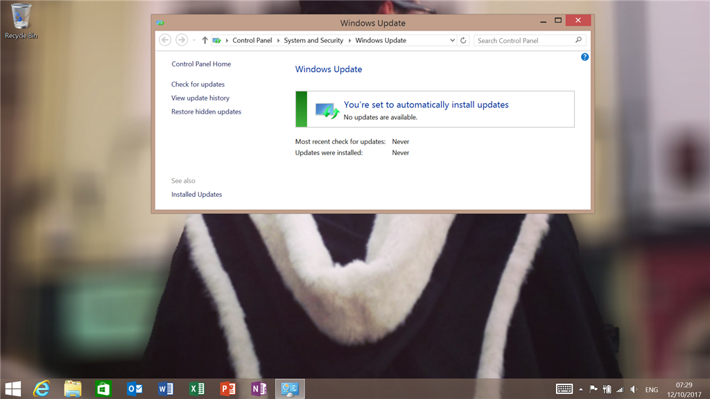

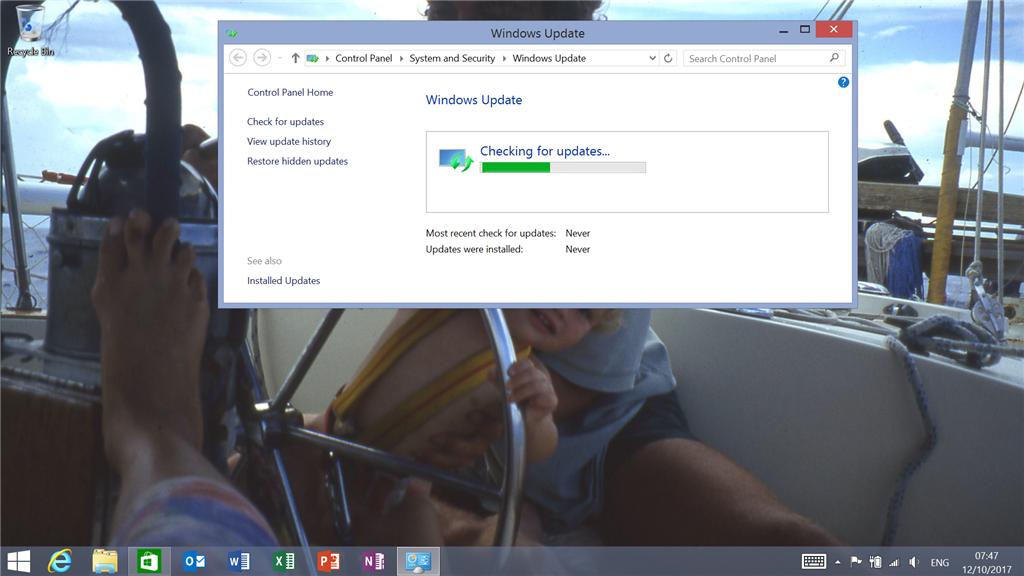

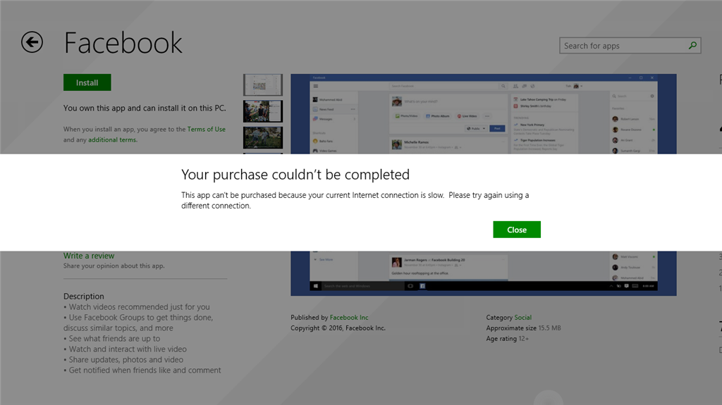

    Yes I was able to log into my MSA, but I cannot get yesterdays Patch Tuesday update, nor can I download any apps from the store even though my download speed is 18MB.
    I have just received a replacement Surface 2 (RT) from MS and can now log in using my MS credentials as well as access and download / install apps from the Store (fb installed just now) BUT it's still saying there are no available updates even though this device is out of the box, and just hangs with the MS message 'checking for updates' (left doing this overnight last night) if I manually check for updates:
