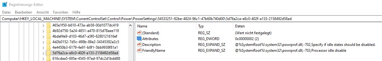

    What I've found is that when the surface book 3 is under full load (i.e. when I'm running a game) the problem is gone. Even if I tab out of the game and leave it in the background the mouse & keyboard stutter/ freeze is eliminated.
    So, following this I changed the registry entry which disables processor idle to appear within the energy settings and then disable it in there alltogether.
    This also eliminated the freeze/ stutter, but of couse is no solution since the surface book 3 slows down to a crawl due lack of CPU ressources.

    Will let you know if the change helps.
