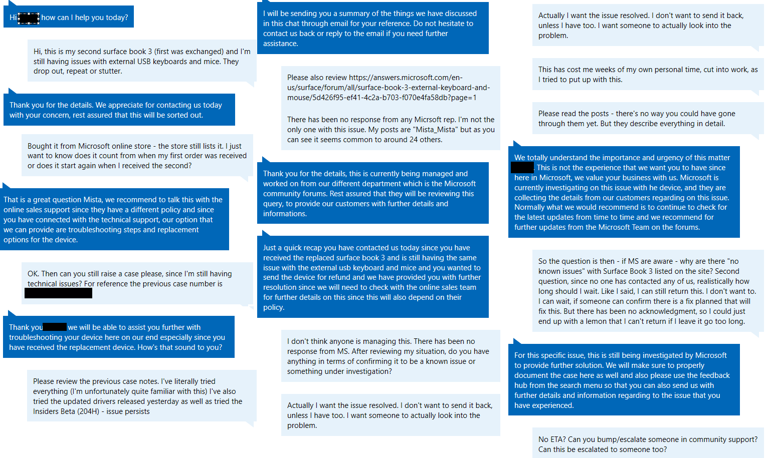

    2020-09-28T09:52:17+00:00
    Can confirm that new drivers do not fix issue.  Still end up with screen freezing.

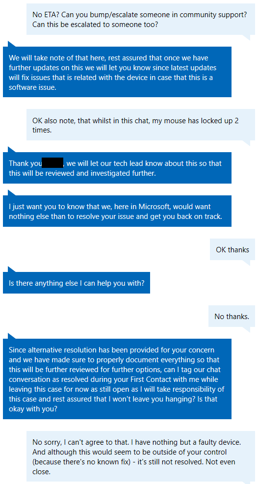

    Most of responses are 'standard boilerplate' but at least they say it is being looked into.  The support person is targeted on closing tickets hence the 'please mark as resolved'.  Please keep us informed.  I also have another ticket open.
    David
    2020-09-27T03:06:00+00:00
    I contacted support today...
    Just got the emailed case reference:
    "We will raise this over to our next level of support so that this will be further reviewed. Normally escalation will take 2-3 business days and once we have further updates, we will let you know."
