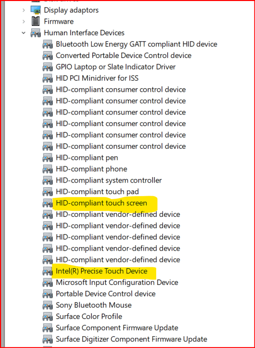

After the recent firmware update, my Surface Pro 7's touchscreen stopped working. I have had this less than 2 months. any advice on how to fix would be greatly appreciated. I have attached a screenshot of my device manager showing an error with Surface ME, Surface UEFI and Intel(R) Precise Touch Device.

    I bought my Surface Pro 7 less than a month ago, up to date with firmware and software updates, Windows 10 Pro version 20H2 build 19042.867. Today I noticed the touchscreen feature is not working, not even with the UEFI screen. I tried several solutions I found, but nothing worked. Finaly I think I can say that it is not a hardware issue, but a software one.
    The touchscreen comes back to life when I uninstall both "HID compliant touch screen" and "Intel Precise Touch Device" drivers and reboot.
    However the touch stop working 5, 10, 20 or more minutes after rebooting. I can't find a pattern to confirm what causes it to stop working again, sometimes plugging/unplugging the Surface Dock also affected, but not every time.
    I hope this helps other people, at least temporarilly.

    2020-02-15T04:02:50+00:00
    Hi Muadibe83,
    Thank you for yor response.
    Please try to Uninstall those drivers having the error. Right-click on them then hit Uninstall device. Note that if you will be prompted for the option to Delete the driver software for this device, leave the box unchecked. Restart then the Surface.
    If the issue still persist, please try to boot the device to the UEFI screen and check if the issue is still present on the UEFI screen. Check this page for the steps on How to get to the UEFI settings. Once you are in the UEFI, try selecting options to identify if the touchscreen is also not working. This is for us to isolate if the issue is a hardware or software issue.
    If the issue is present on the UEFI screen, this could be a hardware issue already and we suggest that you Contact Support to check for replacement options.
    If the issue is not present on the UEFI screen, we suggest that you proceed in doing a Reset on the device using a USB Recovery Image. This option will reimage the entire device and reload Windows including the drivers and firmware. It is the most complete form of Reset and it will wipe out everything on the device so you might need to back up your files first. You will need also a 16GB/32GB of flash drive that must be formatted into FAT32 prior to downloading the Recovery Image. If you like to try, you can follow the steps provided below.
