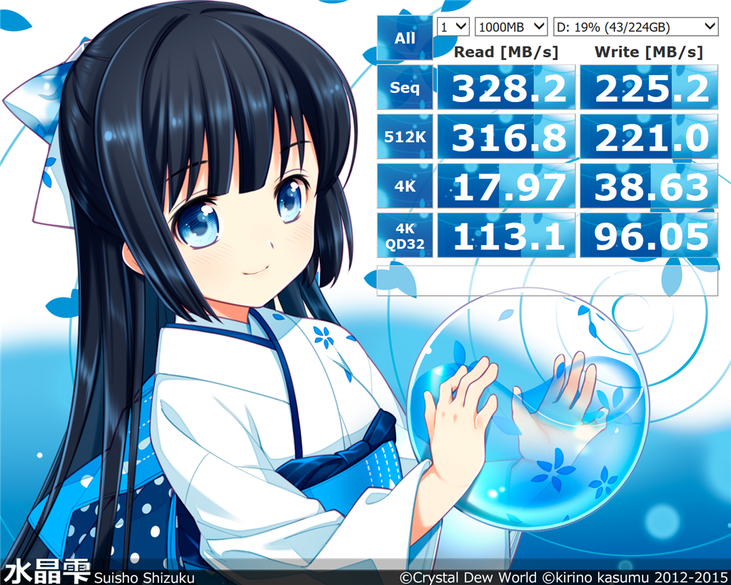

    2016-03-08T08:28:53+00:00
    This is using a Sabrent 2.5-Inch SATA to USB 3.0 enclosure that's Optimized For SSD and  Supports UASP SATA III.  EC-UASP on their product page.
    The SSD I'm using is an Intel 530 Series SSD.
    I already posted this earlier in this thread but just a fair warning though, I don't recommend buying the Sabrent enclosure because they use two types on controller chip, probably from different company assembly lines.  One uses a JMS567 chip and another that uses an ASMT1051.  The ASMT1051 works excellent and was used for the benchmark below, and then there's the JMS567 which  is a total disaster.
