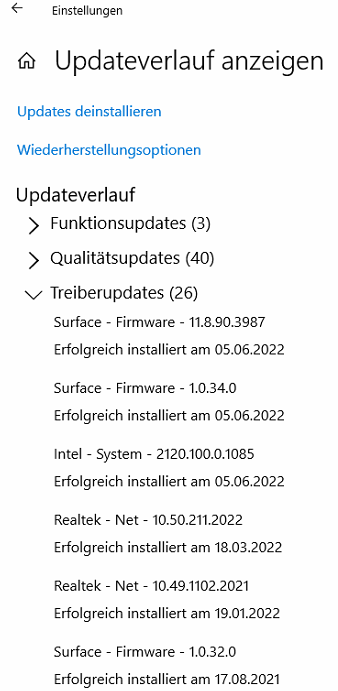

    Just to document here: our Surface Go (v1) is fortunately not affected, is only used when traveling and for that reason does not get all updates on the day of publishing. Installed is ESET Internet Security, Microsoft Office 365 and very few other apps.
    Update history:
    2022-06-05 Surface - Firmware - 11.8.90.3987
    2022-06-05 Surface - Firmware - 1.0.34.0
    2022-06-05 Intel - System - 2120.100.0.1085
    2022-03-18 Realtek - Net - 10.50.211.2022
    2022-01-19 Realtek - Net - 10.49.1102.2021
    2021-08-17 Surface - Firmware 1.0.32.0
    I wish everybody affected the best of luck !!!

    2022-06-17T14:06:05+00:00
    Just to provide a proof (for the ones needing it one day, just in case...) 😉: I made a screenshot on my wife's Surface Go via TeamViewer this morning, and it definitely shows 1.0.34.0 (German Windows):
    2022-06-17T18:53:06+00:00
    Thanks for this Oliver. In the firmware screen we are definitely getting it without the zero, although it may be a red herring.
