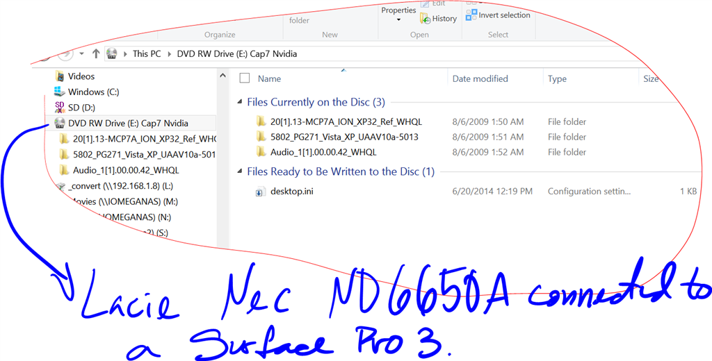

    2014-06-28T20:58:03+00:00
    You will have to find one that's self powered.
    I tried my old Lacie NEC ND-6650A and it works sometimes.
    Warning: This is not a recommendation. This a very old DVD-RW drive and I doubt that's fully supported in Windows 8.1
