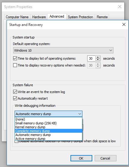

    that was a mini dump. they looked at it. they need a full dump. see instructions above or also at https://www.sophos.com/en-us/support/knowledgebase/111474.aspx and https://support.symantec.com/en_US/article.HOWTO31321.html (I could not find good info on Microsoft owned sites on how to do this).
    Or use MY instructions:
    1. Right click/tap and hold This PC on the desktop
    2. Select Properties
    3. Select Advanced system settings
    4. Select SETTINGS below Startup and Recovery
    5. Change the setting in the drop down from Automatic to Complete
