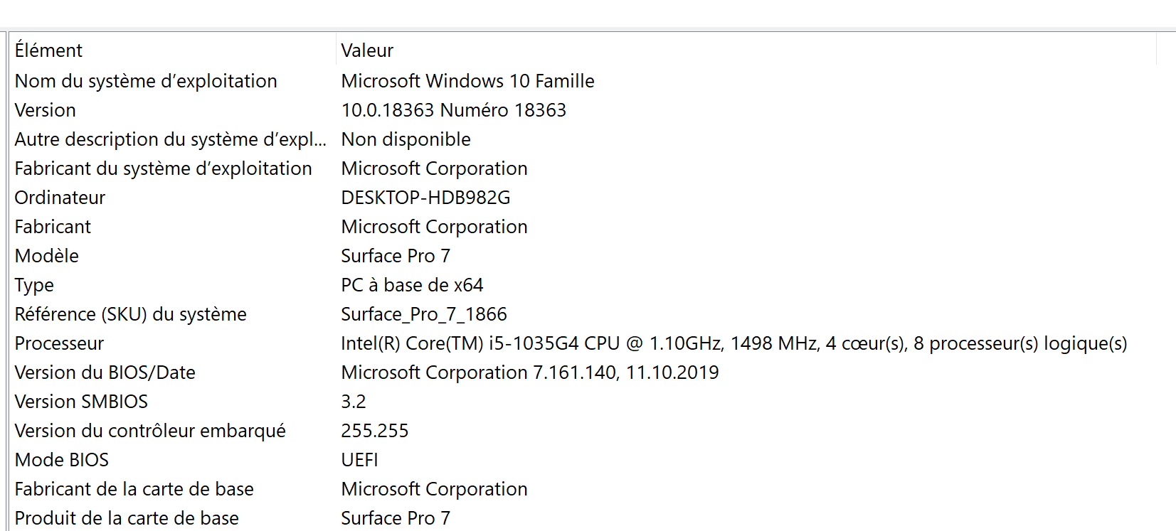

Brand new Spro7, Firmware up-to-date.
I noticed drastic CPU throttling when battery charge level reaches 35%: CPU tops at about 0.5 GHz and setting the power slide to "Best Performance" doesn't change that.

    Here is some interesting additional info:
    It looks like the problem occurs only when the unit is connected to external monitor (USB-C -> HDMI), mouse (BT) & keyboard (USB)  (no docking station).
    When the unit is used with internal display + typecover, the CPU is not throttled down (until it reaches the defined low batt setting)
    Benoit

    Hi Janette,
    as said, there is no docking station (or Surface Dock) involved:
    external monitor is connected using a  USB-C -> HDMI dongle (internal monitor is disabled)
    external mouse is connected via Bluetooth
    external keyboard & Ethernet are connected using a powered 4-port USB 3.0 SS hub
