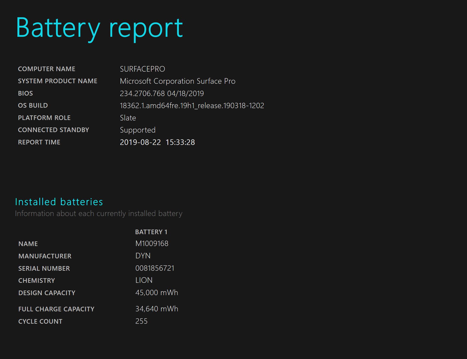

    I have the same problem with my Surface Pro i5, 256.
    Starting to notice battery only lasting a couple of hours on basic tasks. So frustrating. Been checking the battery report and its only had a cycle count of 255 and the battery capacity has dropped to 34,640mWh.

    Thanks, Barb.
    I had re-installed the Battery driver previously (multiple times) and that didn't solve the problem.
    But having seen your suggestion for many of the other posters, I tried that again last night. After that, according to the battery report, the full capacity seemed to have been reset to 34290 mWh. The battery icon started at 100% and seemed to be discharging at about the right rate (as I was looping through continuously on youtube), so I was hopeful for a moment. But power then cut out at 77% without the machine going to suspend. According to batteryreport, it seems to think it had 26,540 mWh left when machine turned off by itself.
    But I'll try another charge/discharge cycle tonight and report back. Thanks.
