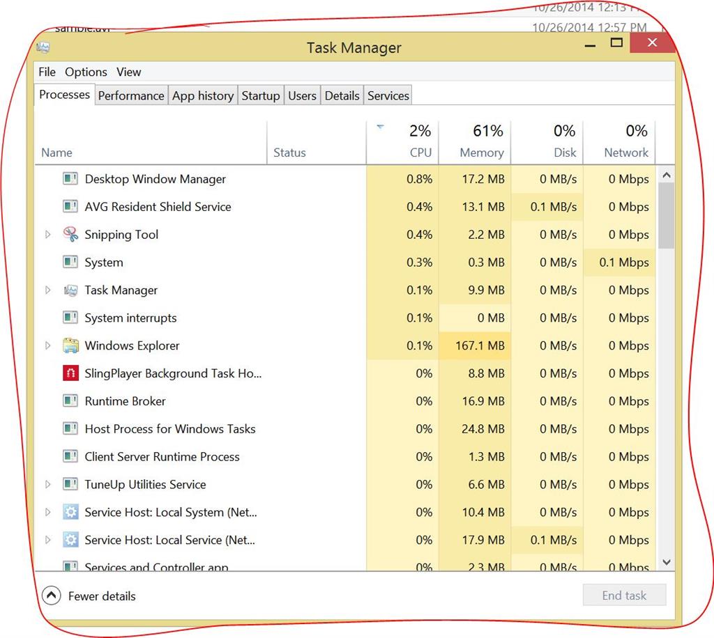

- CPU and graphic temperatures after 5 minutes
- Fan whilst idle (video)
After dropping over $2k on a product, this isn't what I expect to see after 3 minutes of light web browsing:

| 8/10 - nitehawk_967 | i5 -128GB | Yes - <br>1423 | "...my **'host task for windows process'**revs up to 25-30% cpu. and the right hand corner get hot to the touch and fans whir<br> like crazy" |

@CmdrKeene 90,631 Reputation points Volunteer Moderator2014-10-26T18:48:12+00:00 C'mon bud, I work in IT too and I'm on your side. I'm not saying this is the end-all be-all answer (heck, you might press the Ctrl-Shift-Escape and find out that the "culprit" is actually part of the system itself. In fact, that's what it was for me if you read my previous replies. My OneDrive was downloading 100s of GBs of data, and my search indexer was trying to index all that, and together they had my system pegged at 100% usage and caused it to run hot, wear the battery down within an hour, and just overall make the system run dog slow. It could also be an aggressive antivirus scan, or another program causing it to peg at 100%. But no matter what, the simple way to find out is to just follow my advice.
And yes, of course there can be other issues too. None of the SP3's I've deployed to people has ever shown the thermometer error symbol as mentioned here, for example.
All I'm asking is that you just open the Task Manager and at least check to see what's causing the system to be unable to throttle down. Something is causing it, and I'm just asking for you to open the hood and check the dipstick real quick. I'm not trying to nullify the issue at all. Again, I'm on your side, I just want to help further the investigation instead of throwing up my hands and saying "nope, too bad, the hardware is borked!"
