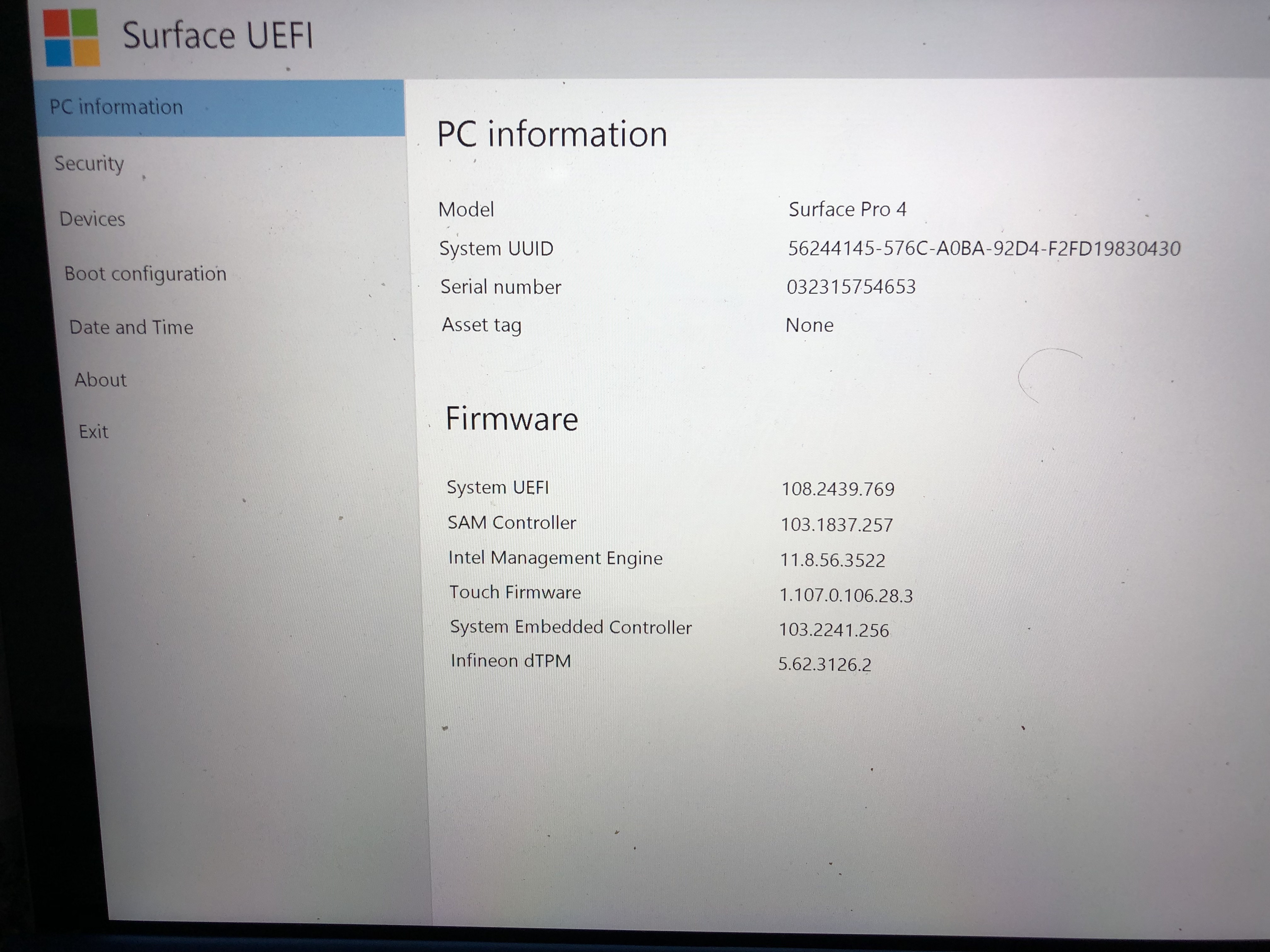

    2019-02-04T00:21:36+00:00
    Thank you for your ideas - it is appreciated.
    I have already turned off the fast startup.
    I've also tried shutting down with the power button (Set to Power down for both battery and mains power profiles)
    Also tried the Windows key and selecting Power - Shutdown
    Also tried the Windows Key + X then U U
    Will try the command prompt tonight
    Have also tried disconnecting type cover in case it was that which was discharging the battery.
    Below are the Firmware versions which windows update says is up to date
