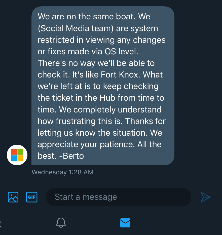

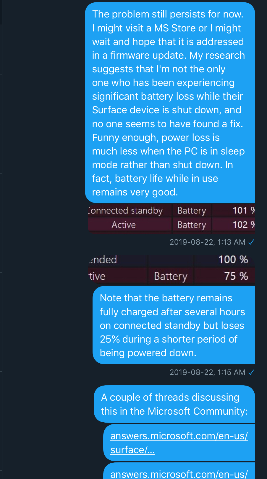

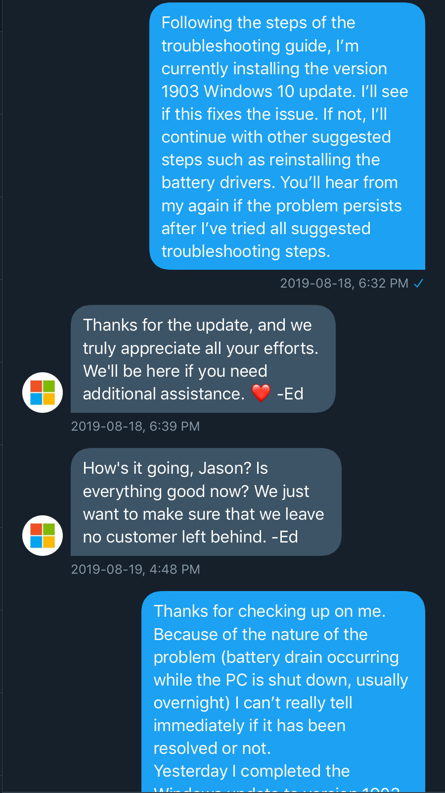

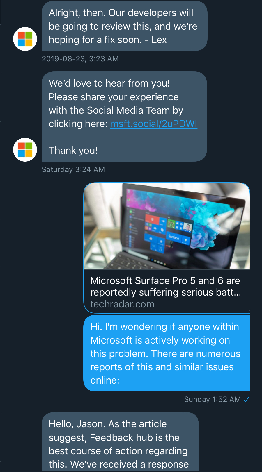

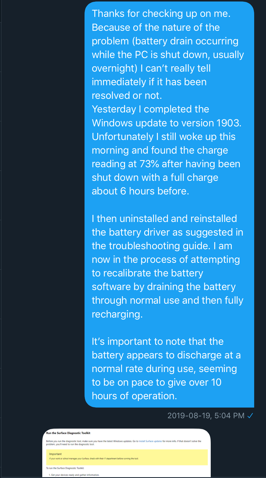

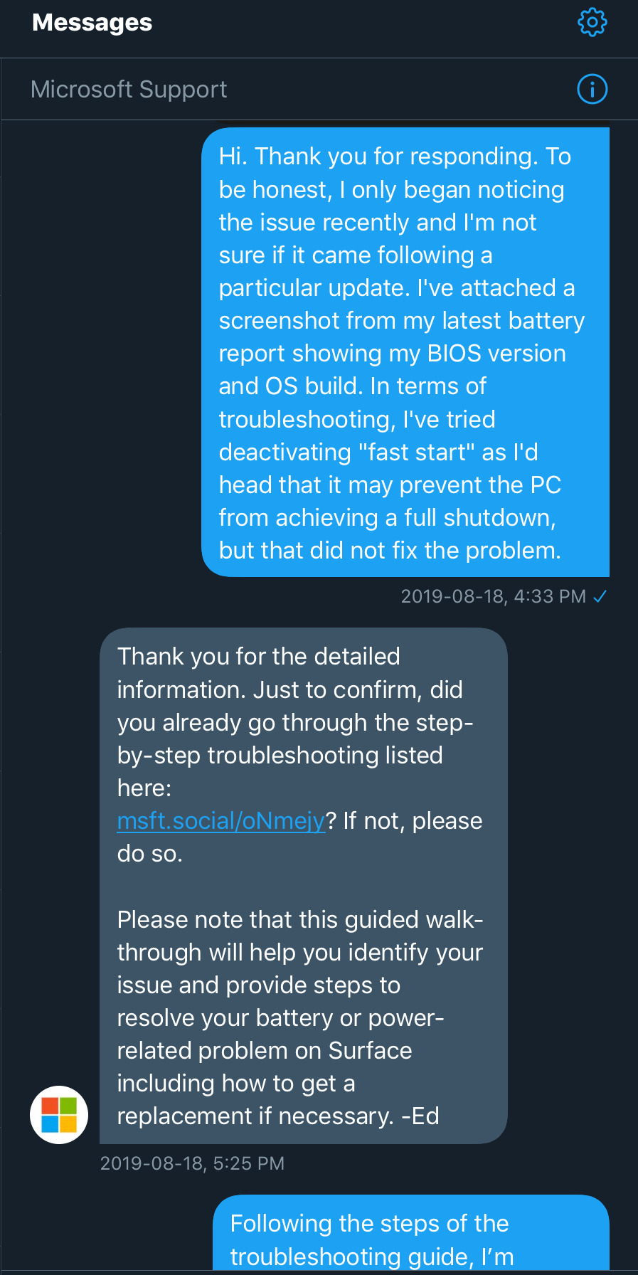

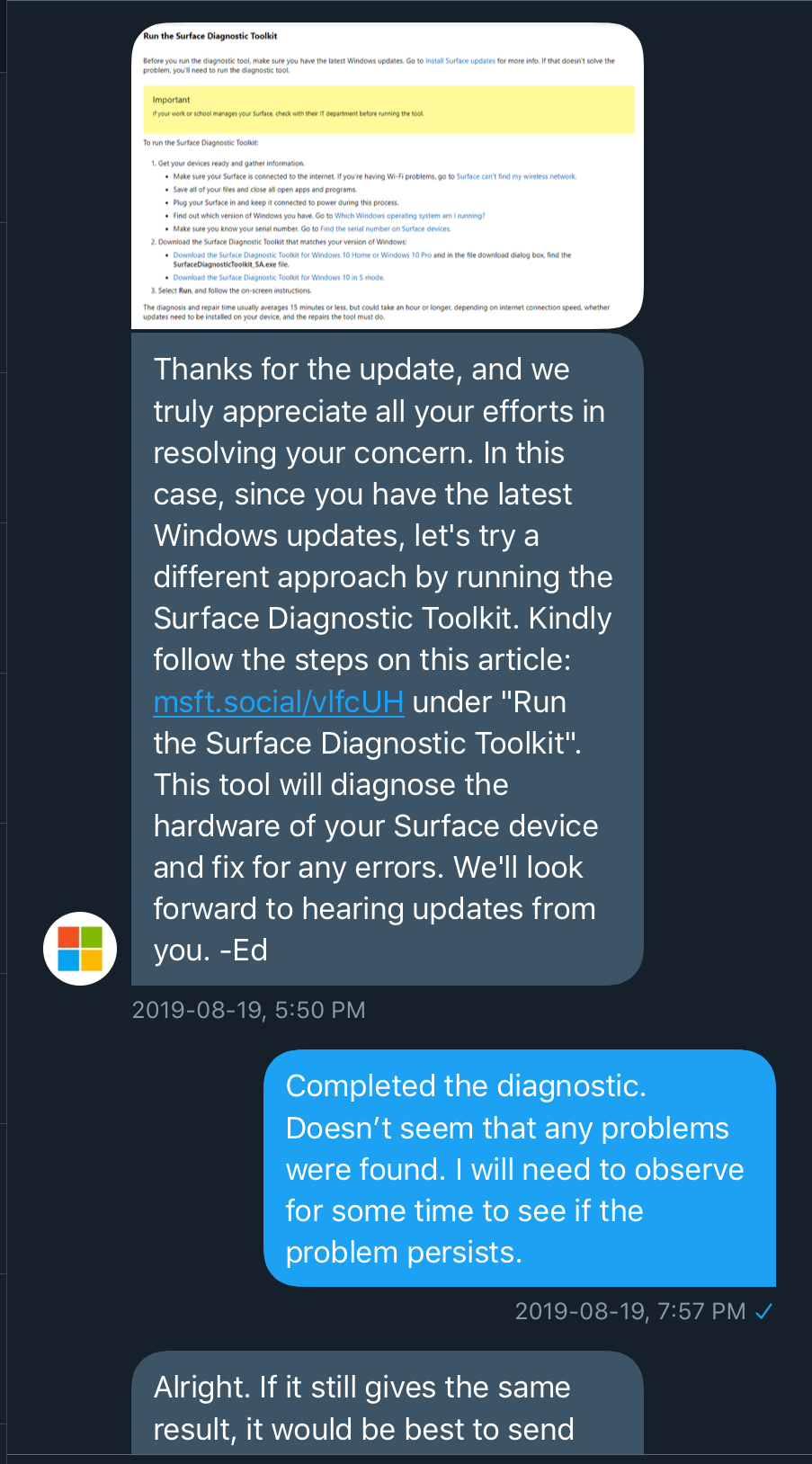

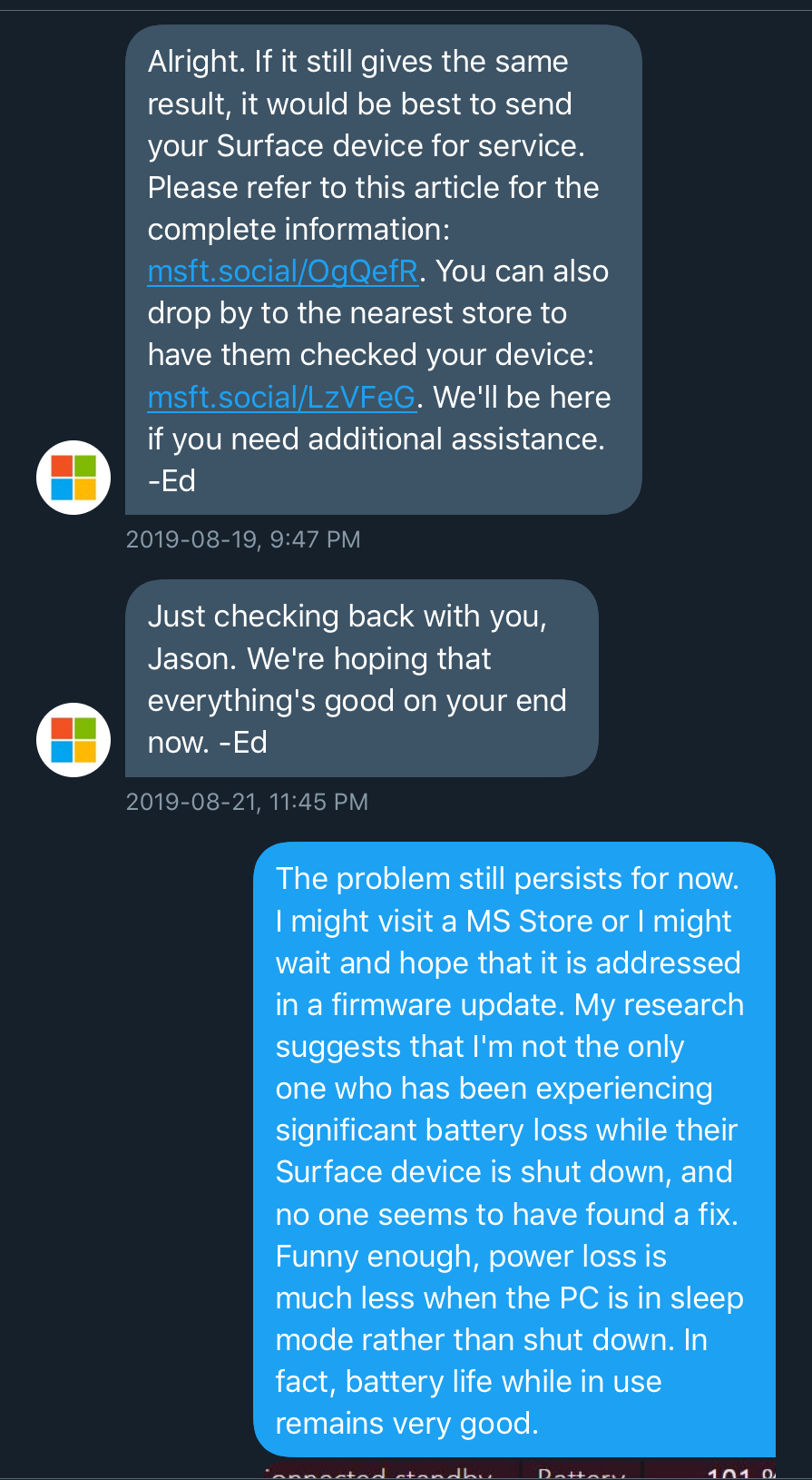

    Interesting Twitter conversation, that! It makes me wonder how can a tech company run like this!?
    I had a 3-hour long chat with a Microsoft agent on the Get Help app as I was having the same problem in the replacement device they sent me. And of course also in my original device which I purchased in May 2019.
    I have been told that they have a specially tested replacement device that surely does not have this battery problem which they will be sending me. I'm hoping this solves the problem. I also have an email saying that if the replacement device i get also has the problem, then they will give me a brand new device.
    Now I'm not sure what happens if the brand new device also has the problem, but I'm going ahead with this process and see where things go. I'm curious to know what Microsoft will do after they have exhausted all their options.
