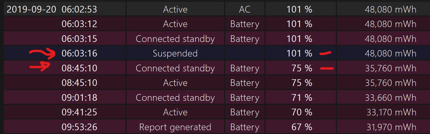

    Exact same issued on my Surface Pro 6. I shut down at fully charged before leaving to work. Turned it on at work 3 hours later and the battery drained to 75%. WTH.

    After more investigation and google search, i found the following article: https://www.reddit.com/r/Surface/comments/d6bze7/possible_fix_for_battery_issues_on_surface_pro_6/
    Indeed, the Release Preview ring of the Insider program contains a new firmware update at least for the Surface Pro 6, and after the first try (firmware update, then shutdown and letting rest for about 6 hours) i don't have a battery drain any more. I will verify a few more times, but it seems that the firmware update fixed the problem at least for my device. Not sure when the final release date is planned for everyone, but it shouldn't take much longer.
